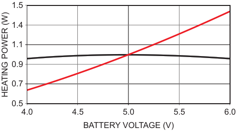

Nulled (black) and uncompensated …
Nulled (black) and uncompensated (red) Q1 heating versus battery voltage droop (5 ±1 volts)

Figure 4. Figure 1's anemometer modified with U2, A1, and R11 - 14 to servo Q1 and Q2 bias currents to (mostly) null the effects of battery voltage droop
Figure 5. Nulled (black) and uncompensated (red) Q1 heating versus battery voltage droop (5 ±1 volts)
