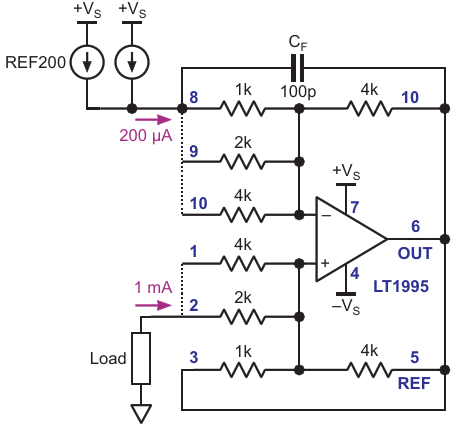

Precision programmable current source uses two ICs
Figure 1. I
REF
can be increased or decreased to the load depending on N
Figure 2. LT1996 used as a pin-strap-programmable current sink/ source, in this case, dividing the reference current by 10
Figure 3. LT1995 sinking five times the reference current
