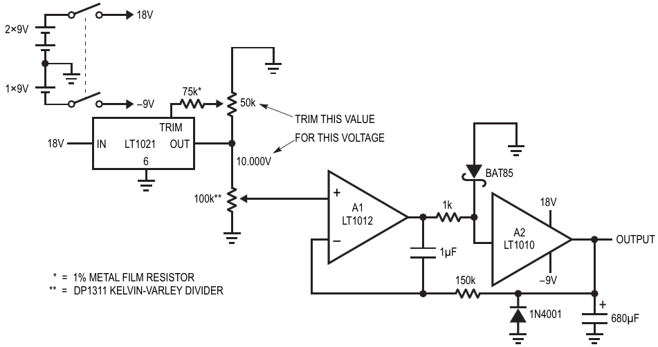

Battery simulator has floating …
Battery simulator has floating output settable within 1 mV. A1 unloads Kelvin-Varley divider; A2 buffers capacitive load
Jim Williams
Floating output, variable potential battery simulator
Figure 1
