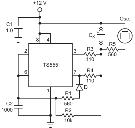

Application circuit for measuring …
Application circuit for measuring the ESR of a capacitor using the concept introduced in Figure 2

Figure 3. Application circuit for measuring the ESR of a capacitor using the concept introduced in Figure 2
