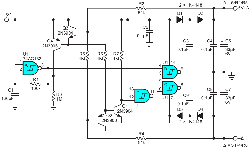

Brute force mitigation of PWM VDD and ground "saturation" errors
Figure 2
18 Kb
Figure 1. U1 is a multi-pole (e.g., 74AC04 hex inverter) PMW switch where op-amp A1 forces switch zero state to accurately track 0 = zero volts, op-amp A2 does the job for 1 = V
DD
Figure 2. A practical source for V+ and V- set R1 and R2 = 200k for ∆ = 1 volt
