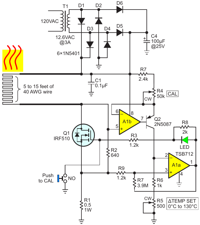

A switch mode thermostat …
A switch mode thermostat efficiently heats melded copper wire sensor/heater

Switch mode hotwire thermostat
Figure 1,
22 Kb
Figure 1,. A switch mode thermostat efficiently heats melded copper wire sensor/heater
Figure 2,. Linear mode hot wire thermostat that uses the tempco and I
2
R heating of 40 AWG copper wire as a melded sensor/heater
