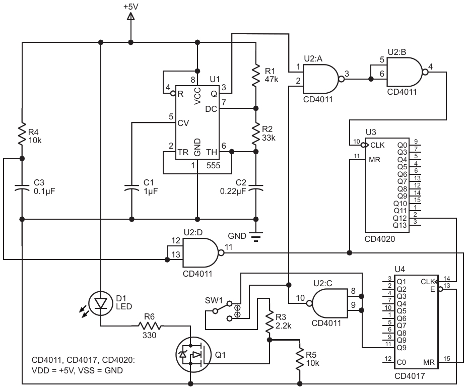

The above circuit produces an OFF delay of 30 minutes. The switch SW1 can be thrown on the other side at starting to get a 30 minute ON delay. The capacitor C2 can be changed to get various timings. The required load can be connected in place of LED D1
