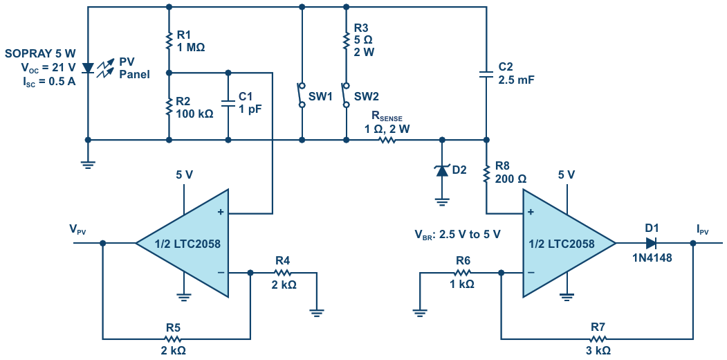

PV sweep measurement with the LTC2058
Aaron Schultz, Catherine Chang, Henry Surtihadi
Precise photovoltaic I-V characterization
Figure 1
17 Kb
Figure 1. PV sweep measurement with the LTC2058
