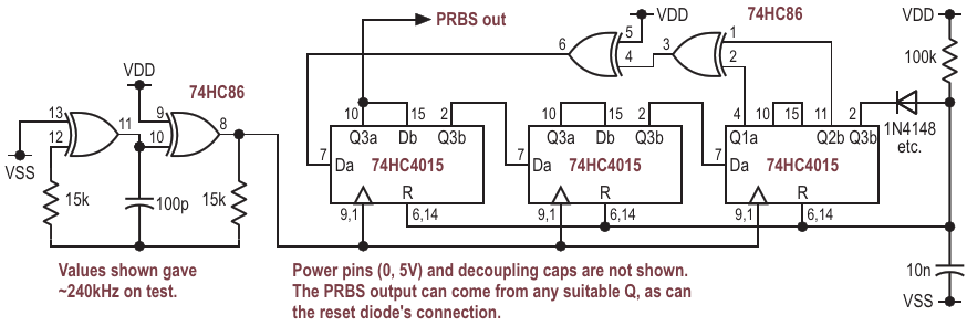

A pseudo-random sequence generator …
A pseudo-random sequence generator (PRSG) built with standard logic ICs generates wideband white noise

Figure 1
22 Kb
Earplugs ready? Let's make some noise!
Figure 1. A pseudo-random sequence generator (PRSG) built with standard logic ICs generates wideband white noise
