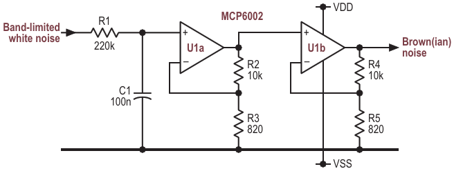

This simple circuit converts …
This simple circuit converts white noise into Brownian

Figure 5. This simple circuit converts white noise into Brownian
