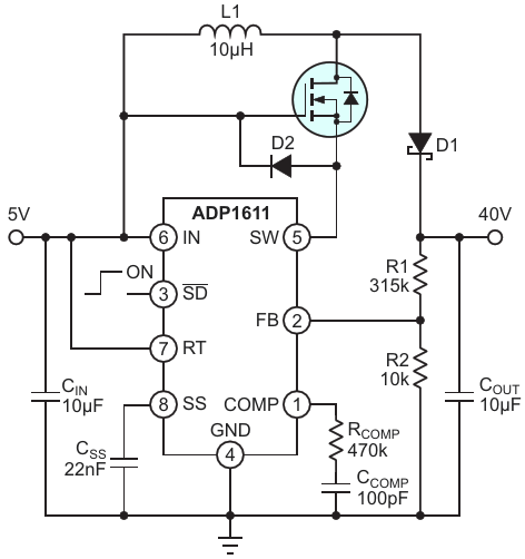

A 5 V to 40 V step-up regulator with the addition of the GaN FET

Expanding output range of step-up converter
Figure 1. An application circuit for the 5 to 15 V ADP1611 step-up regulator
Figure 2. A 5 V to 40 V step-up regulator with the addition of the GaN FET
