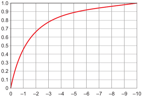

Figure 3. The PWM D required for any desired V
OUT
. PWM D = |V
OUT
|/(0.875 |V
OUT
| + 1.25)
Figure 4. D (x-axis) versus V
OUT
(y-axis) is (fairly) close to a logarithmic function, which makes good use of limited 8-bit PWM resolution
