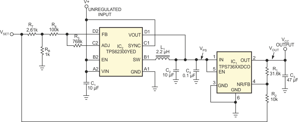

Figure 1 shows a cascade circuit comprising an SMPS followed by a linear regulator. This circuit's output voltage ranges from 1.5 to 5 V at an output current as high as 400 mA. Although a fixed 6 V supply powers the cascaded circuit, its design accommodates any input voltage at least 0.5 V higher than the cascaded pair's desired output voltage.
Low-dropout regulator, SMPS cascade suppress ripple, maintain efficiency
Figure 1. Connected in cascade, a low-dropout linear regulator and a switched-mode
power supply improve output-voltage ripple and maintain overall efficiency.
(Note: In IC1’s part designation, “XX” represents the regulator’s output voltage.)
Adjusting the reference voltage, VSET, over 0 to 1.105 V linearly varies the circuit's output voltage. Resistors R1 and R2 and reference voltage VSET determine the low-dropout regulator's output voltage and thus the cascaded pair's output voltage. Resistors RT, RB, R3, and R4 divide VSET to maintain the SMPS' output voltage, VPS, at a constant 0.2 V higher than the regulator's output voltage, reducing the regulator's power dissipation to 80 mW at full output current and any output voltage.

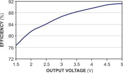

At its maximum output current of 400 mA, the cascaded supply reaches a maximum efficiency of 89% with a 6 V input and a 4.69 V output (Figure 2). The overall efficiency decreases as the output voltage decreases. Figure 3 compares the PSRRs of the SMPS alone and of the SMPS cascaded with the regulator, which improves PSRR by 46 dB at 500 Hz – essentially that of the regulator alone at 500 Hz.
Figure 2. The regulator cascade’s combined efficiency improves as
the unregulated output voltage increases.

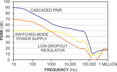

Over a frequency range of 100 Hz to 100 kHz, the low-dropout regulator improves PSRR by at least 25 dB (Figure 3). Circuit-layout and -measurement techniques compound the difficulty of making accurate small-signal measurements, and the graph's PSRR values may not appear additive. The linear regulator governs the circuit's switched-load transient response, which may represent an improvement over the response of the SMPS. However, the cascade circuit's low output ripple and high efficiency make the circuit well worth investigation.
Figure 3. The power-supply rejection ratio improves significantly (blue trace) when you
cascade switched-mode (yellow trace) and linear (red trace) voltage regulators.
