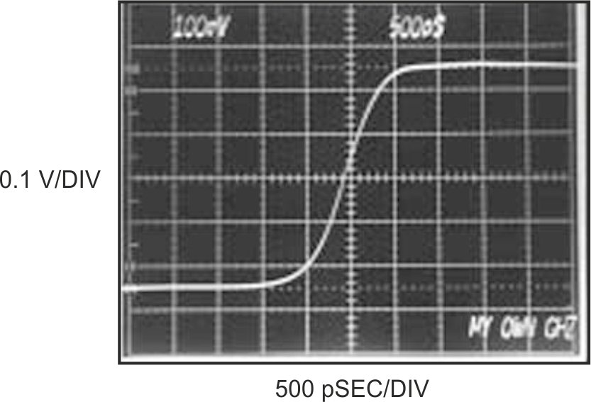

The circuit's output transition is extremely fast and singularly clean. Figure 2, viewed on a 1-GHz real-time-bandwidth oscilloscope, shows 850-psec rise time with exceptionally pure pretransition and post-transition characteristics. Figure 3 details the pulse-top settling. The photo shows the pulse-top region immediately following the positive 500-mV transition. Settling occurs within 400 psec of the edge's completion with all activity within ±4 mV. The 1-mV, 1-GHz ringing undoubtedly stems from breadboard-construction limitations; you can probably eliminate it by using stripline-layout techniques. The level of performance of this circuit requires some trimming.

Figure 2. Viewed with 1-GHz bandwidth, pulses are
free of discontinuities and anomalies.
