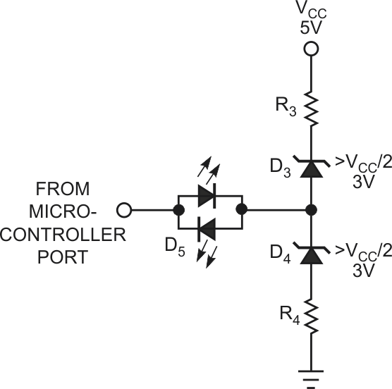

Figure 2 presents an approach that also involves a major disadvantage. Zener diodes D3 and D4 and resistors R3 and R4 form a low-impedance voltage divider that applies VCC/2 V to one end of LED D5. The value of VCC drives the selection of the zener diodes' voltage, VZ, with lower voltage zener diodes allowing more LED current and higher voltage ones limiting maximum LED current. Given that the microcontroller's outputs can deliver rail-to-rail voltages, the difference between VCC and VZ limits maximum forward current for both LEDs. For example, if VCC is 5 V and VZ is 3 V, the forward voltage across either LED is less than 2 V. Once a designer selects the zener-diode voltage, only small variations in VCC can occur; otherwise, the LEDs' brightness would fluctuate.

Figure 2. A zener-diode and resistor voltage divider exhibits sensitivity to
supply-voltage variations and allows LED brightness to vary.

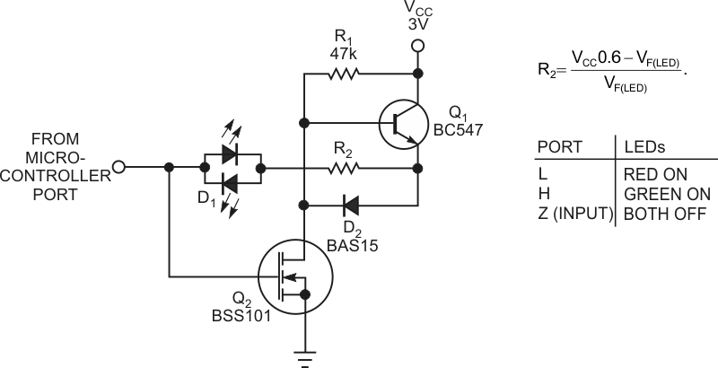

Using discrete components, another circuit offers an inexpensive approach that avoids the other circuits' disadvantages (Figure 3). When the microcontroller's output port goes high, current flows through the green (upper) LED, R2, D2, and FET Q2, which the port's high level turns on. When the microcontroller's output port goes low, transistor Q1 turns on and delivers current to the port pin through R2 and the red (lower) LED. The circuit operates symmetrically because silicon diode D2's forward-voltage drop is present regardless of whether the microcontroller's port pin goes high or low. VCC may vary during operation but must remain higher than 3 V.

Figure 3. This circuit provides immunity to supply-voltage fluctuations and more uniform
LED brightness.
You can individually adjust the LEDs' currents to equalize brightness or compensate for a difference between the microcontroller's power-supply voltage and the LED-driver circuit's VCC. Replace R2 with two resistors connected in series between Q1's emitter and D2's anode. Connect the midpoint of the two resistors to the LEDs.
With the microcontroller's port pin configured as an "input with pullup," the port delivers a small current to the green LED. However, pullup-resistor values of 22 kΩ or higher do not cause misleading light output from LEDs in the off-state. When the input signal from the port pin floats – that is, with VCC at 5 V and the port configured as an input with no pullup resistor – the circuit draws no additional current, and the quiescent current, which R1 determines, averages less than 100 µA.
