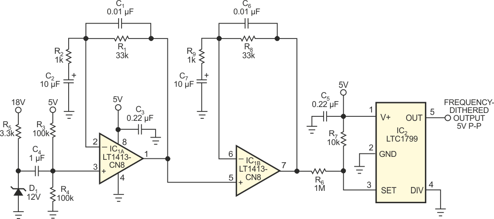

Another approach adds a dithered-frequency, constant-amplitude signal. Figure 1 shows one possible implementation featuring a Linear LTC1799 programmable oscillator, IC2, that's operated in a VCO (voltage-controlled-oscillator) mode in which an applied voltage modulates the center frequency. You can set the LTC1799's center frequency at 1 kHz to 33 MHz, making it a suitable dither generator for many currently available A/D converters. Because the LTC1799's output comprises a square wave, its peak output amplitude is well-defined.

Figure 1. A zener diode, two stages of amplification, and an FM voltage-controlled oscillator form a constant-
amplitude dither generator.

The circuit in Figure 1 operates with a 20-MHz sampling A/D converter and generates random noise around a center frequency of 10 MHz. You can use any of a number of techniques to generate the random noise, including digital shift registers and semiconductor junctions biased into the breakdown range. In this design, a 12 V zener diode, D1, generates the noise, which a two-stage amplifier amplifies and frequency-shapes. If necessary, you can further shape the noise distribution by using more complex active-filter sections, IC1A and IC1B. After filtering, the noise modulates the LTC1799. Make sure that the LTC1799's power-supply voltage is pure dc and free of ripple, because power-supply noise produces nonrandom AM sidebands.

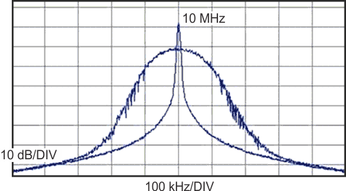

Figure 2 shows an amplitude-versus-frequency plot of the frequency-limited spectrum that the design in Figure 1 produces. Depending on the circuit's configuration, you can apply the dither to the A/D converter using a small coupling capacitor or a more complex active summing circuit. Although zener-diode noise generators offer theoretical simplicity, they behave poorly in production environments because their noise outputs can vary greatly. Even among diodes from the same manufacturing batch, you can observe popcorn noise, unevenly distributed noise histograms, amplitude shifts, and frequency-weighted noise. In a high-volume application, well-specified noise diodes may prove more cost-effective than zener diodes.

Figure 2. The broad bell-shaped curve shows a random-frequency-
dithered spectrum superimposed onto the LTC1799’s
unmodulated, 10-MHz output.
Once you select a noise diode, you can select amplification-stage gains such that clipping of noise peaks isn't evident at the circuit's output. If your application requires it, you can alter the amplifiers' frequency responses to alter the noise spectrum. Finally, adjust the LTC1799's frequency-setting resistors, R6 and R7, so that the noise-spectrum display resembles that in Figure 2. Any clipping along the amplifier path tends to add peaks to the edges of the spectrum, which indicates amplitude clipping and reduction of the noise's random characteristics.
You can add a filter between the noise output and the A/D converter's summing input to limit inband noise or remove any periodic modulation that power-supply ripple introduces. In a modern, high-performance A/D converter, even a small amount of periodic noise can manifest itself as a –80-dBc (decibels-below-carrier) spurious response.
