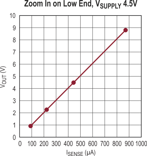

A critical specification for a current sense solution is the zero point, or equivalent error current at the input for the output produced when no sense current is present. The zero point is generally determined by the input offset voltage of the amplifier divided by RSENSE. The LTC2063’s low input offset voltage, of typical 1 μV, maximum 5 μV, and low typical input bias and offset currents of around 1 pA, allow for a zero point input-referred error current of only 10 μA (1 μV/0.1 Ω) typically, or 50 μA (5 μV/0.1 Ω) maximum. This low error allows the sense circuit to maintain its linearity down to the lowest current in its specified range (100 μA), without plateauing due to loss of resolution, as seen in Figure 2. The resulting input current to output voltage plot is linear over the entire current sense range.
Precision Ultralow Power High Side Current Sense
Figure 2. No Plateau at the Low End, Down to 100 μA ISENSE.

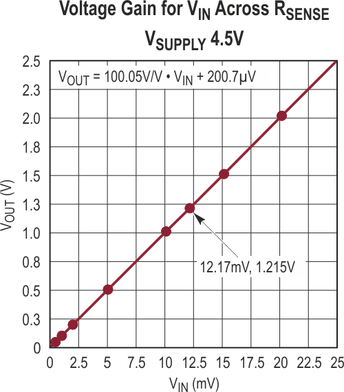

The LTC2063’s input offset voltage contributes a fixed input-referred current error of 10 μA typical. Out of 250 mA full-scale input, the offset results in only 0.004% error. At the low end, 10 μA out of 100 μA is 10% error. Since the offset is constant, it can be calibrated out. Figure 3 shows that total offset from LTC2063, unmatched parasitic thermocouples, and any parasitic series input resistances is only 2 μV.
Figure 3. VIN to VOUT Conversion on Minimum Supply 4.5 V
for Entire ISENSE Range. Output Offset of 200.7 μV,
when Divided by 100.05 V/V Voltage Gain, Implies
RTI Input Offset of 2 μV.
The gain shown in Figure 3, 100.05 V/V is 1.28 greater than the expected gain given by the real values of RLOAD and RIN, or 98.77 V/V. This error may be due to the different temperature coefficients of RLOAD and RIN. The main source of uncertainty in the output of this circuit is noise, so filtering with large parallel capacitors is crucial to reduce noise bandwidth and thus the total integrated noise. With a 1.5 Hz output filter, the LTC2063 adds about 2 μVP-P low frequency, input-referred noise. Averaging the output over the longest possible duration further reduces error due to noise.

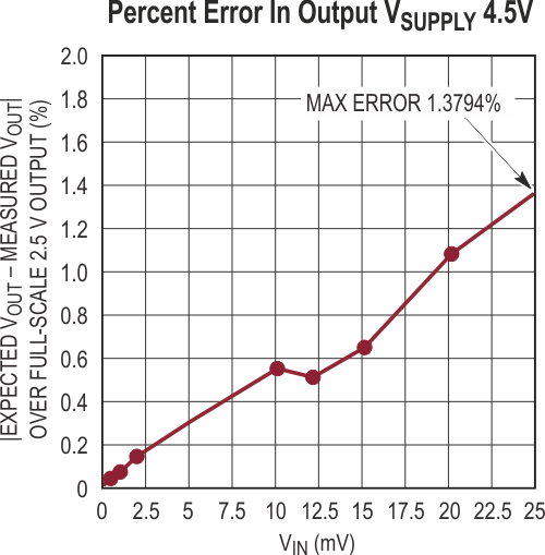

Other sources of error in this current sense circuit are parasitic board resistance in series with the RSENSE at the LTC2063 input, tolerance in resistance values of the gain-setting resistors RIN and RLOAD, mismatched temperature coefficients in the gain-setting resistors, and error voltage at the op amp inputs due to parasitic thermocouples. The first three sources of error can be minimized by using Kelvin sense 4-lead sense resistors for RSENSE, and using 0.1% resistance with similar or low temperature coefficients for the critical gain-set path of RIN and RLOAD. To cancel out the parasitic thermocouples at the op amp inputs, R1 should have the same metal terminals as RIN. Asymmetric thermal gradients should also be avoided as much as possible at the inputs.
Figure 4. Percent Error Remains Below 1.4% for Entire
Range of Readings.
The overall contribution of all the error sources discussed in this section is at most 1.4% when referenced against full-scale 2.5 V output, as shown in Figure 4.

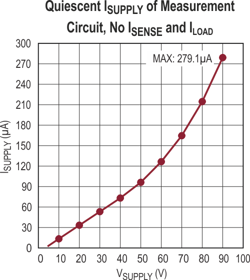

The minimum supply current required by the LT1389 and LTC2063 is 2.3 μA at the minimum VSUPPLY and ISENSE (4.5 V and 100 μA), up to 280 μA at maximum VSUPPLY and ISENSE (90 V and 250 mA), as shown in Figure 5. In addition to the current consumed by the active components, an output current through M1 also supplied by VSUPPLY is required, proportional to the output voltage, ranging from 200 nA for a 0.1 mV output (for 100 μA ISENSE) to 500 μA for a 2.5 V output (for 250 mA ISENSE). Thus, the total supply current in addition to ISENSE ranges from 2.5 μA to 780 μA. RLOAD is set at 5 kΩ for a reasonable ADC drive value.
Figure 5. Supply Current Increases with Supply Voltage
but Never Surpasses 280 μA.
