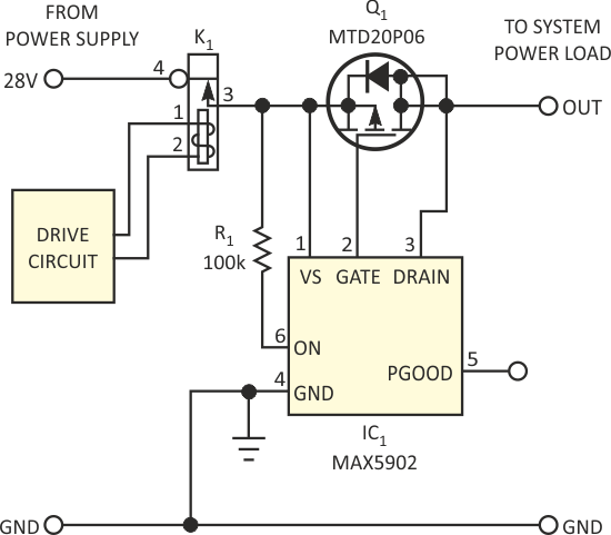

One approach to contact bounce combines a relay with a hot-swap controller. Such controllers are increasingly popular as the means for switching system components without shutting down the system power. In Figure 1, a relay contact replaces the pin of a mechanical connector.
A hot-swap controller IC and external MOSFET remove contact bounce from relay K1.
Figure 1. A hot-swap controller IC and external MOSFET remove contact bounce
from relay K1.
The drive circuit drives the relay closed, and that relay closure connects the input of the hot-swap circuitry to the power supply: 28 V, in this case. The hot-swap controller, IC1, keeps the p-channel MOSFET, Q1, off for a minimum of 150 msec after the input supply reaches a valid level. That delay allows ample time for contact bounce in the relay to subside. After the 150-msec delay, IC1 drives the MOSFET gate such that the output voltage slews at 9 V/msec. This controlled ramp rate minimizes the inrush current, thereby reducing stress on the power supply, the relay, and capacitors downstream from the hot-swap controller.

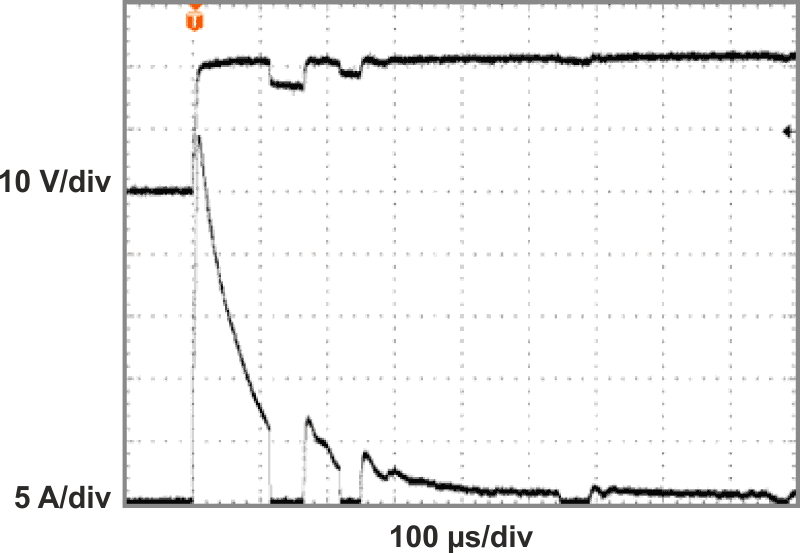

The mechanical relay K1 by itself exhibits contact bounce on closure.
Figure 2. The mechanical relay K1 by itself exhibits contact
bounce on closure.

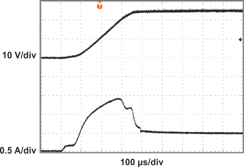

An example of relay contact bounce shows three bounces with an inrush-current peak of almost 30 A (Figure 2). The top trace is output voltage at 10 V/division, the lower trace is input current at 5 A/division, and the output load is 54 Ω in parallel with 100 µF. Use of the Figure 1 circuit under these conditions yields a better picture (Figure 3). The delayed rise in output voltage is clearly visible, with no hiccups arising from contact bounce. The input current shows much less variation, peaking under 1.5 A before settling to a steady-state value of 500 mA.
