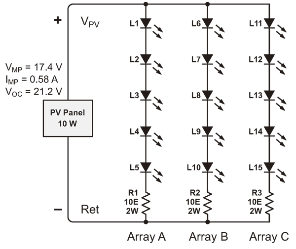

The circuit diagram of the resistor-based day lamp is shown in Figure 1.
This schematic of the 10 W solar day lamp includes resistive current limiting.
Figure 1. This schematic of the 10 W solar day lamp includes resistive current limiting.
Figure 1 illustrates three LED arrays, A, B, and C, each having 5 LEDs (L1-L5, L6-L10, L11-L15) and a 10 Ω current limiting resistor. The three PCBs containing the LED arrays were assembled on an aluminum channel, which acts as a mechanical support and as a heat sink (Figure 2). To optimize heat transfer, a thin layer of thermal compound was applied to the LED PCBs before they were mounted onto the aluminum channel.

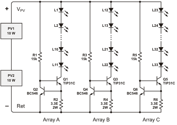

Design #2: Active current limiter
The resistors in the circuit of Figure 1 can be replaced with an active current limiting circuit. In this design, we are using two 12 V PV panels connected in series to drive longer strings of LEDs to provide more light. Note that if it’s more cost-effective, a single 24 V PV panel may be used instead of the two 12 V panels.
The values for this design are calculated as follows:
Number of LEDs per series string is
Rounding down, the maximum number of LED in a series = 11 LEDs.
Number of LED arrays is
(round up to 3 arrays).
Current through each array
Here is the schematic of a 20 W solar day lamp with active current limiting.
Figure 4. Here is the schematic of a 20 W solar day lamp with active current limiting.
As shown in Figure 4, the current limiting circuit consists of a power transistor Q1 (TIP31C). The LED array A is connected to the collector of Q1. Q1 is biased using resistor R1. In the emitter circuit, current sensing resistor R2 is included. Voltage across R2 is sensed using Q2. When the drop across R2 reaches 0.6 V, Q2 turns ON. This pulls down the base voltage of Q1, and current is limited to:

The advantages of active current limiting
The active current limiting circuit maintains the LED current at a constant, safe level during periods when higher-than-average solar inputs cause the panels to generate voltages > VMP. In addition, even if one LED array fails, the remaining arrays will continue to work without any problem. It also allows the higher-power 20 W PV panels to support several LED lamps that can be switched on or off as needed. Despite the varying load, the current limiter circuit ensures that each panel’s LED current does not exceed its set value.

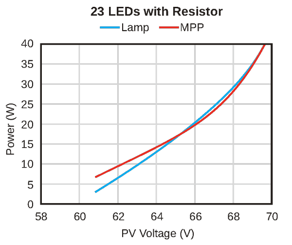

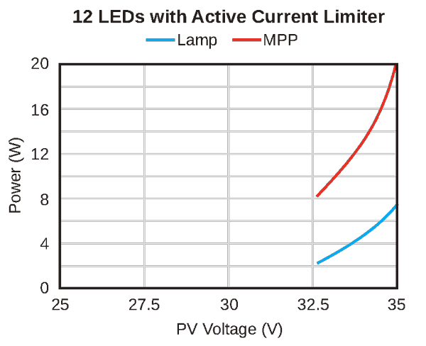

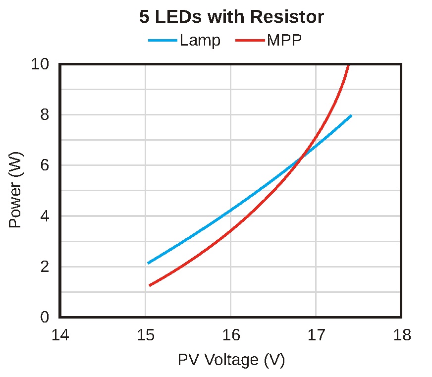

Performance of the solar day lamp is evaluated based on how well it tracks the panel’s maximum power point (MPP) curve under different values of solar illumination. For a given PV panel, there is a MPP curve. This curve is generated by connecting variable load resistance to the panel. The load resistance is varied to get the MPP (VMP and IMP) for a given solar illumination. This process is repeated for different conditions of solar illumination and the data is used to plot a graph of VMP vs power.
While testing the day lamp, lamp current and PV voltages are recorded for a series of different conditions of solar illuminations. Tests were carried out on the following lamp versions and the results are compared with the standard MPP curve.

Figure 9 shows the results for a single PV panel having 5 LEDs in each array and resistor current limiter. Figure 10 represents two PV panels having 11 LEDs in each array and active current limiter. Figure 11 shows the results for two PV panels having 12 LEDs in each array and active current limiter. And Figure 12 shows four PV panels having 23 LEDs in each array and resistor current limiter.
This photo shows the design with 4 PV panels and 3 arrays with 23 LEDs each.
Figure 13. This photo shows the design with 4 PV panels and 3 arrays
with 23 LEDs each.
In conclusion, the lamp using a resistive current limiter circuit tracks the MPP curve well at low power levels. At higher power levels the lamp provides significantly less power. The solar day lamp using active current limiting closely tracks the MPP curve, thus providing maximum light for any given power input. In this configuration, the optimum number of LEDs in an array is 11 as seen in Figure 10. Figure 11 shows how the power output of a 12-LED array is significantly lower.
In some regions of the above plots, it is seen that the power output is even higher than the MPP curve. This may happen due to one or more of following reasons:
  1. The values of VMP and IMP are not fixed. Manufacturers specify a typical tolerance of about ±5%.
  2. The MPP curve is generated using resistive load. In contrast, LEDs are nonlinear loads and the panel may work differently with non-linear loads.
The reason why LED loads track the power so well is because of the variation in LED forward voltage VF with current. As the LED current reduces, there is a slight reduction in VF. This matches with the MPP curve, which results in close tracking naturally.
