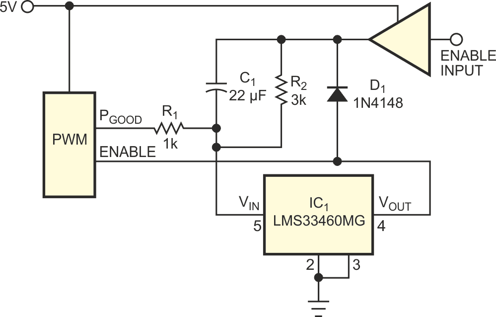

Many power-supply designers like to have a regulator latch off in the event of an overcurrent situation or other fault condition. Yet, many PWM controllers do not internally support this latch-off function. Most do, however, have a power-good output and an enable function. The circuit in Figure 1 adds that latch-off capability at low cost in little additional space. The design is based on the LMS33460, which is a power-supply monitor in a tiny, five-lead SC-70 package. You just need to combine it with a few small passive parts, and the circuit is complete.
This circuit adds a latch-off function to PWM controllers lacking this feature.
Figure 1. This circuit adds a latch-off function to PWM controllers lacking this feature.
When the Enable Input signal goes high, the voltage at the top of C1 rises quickly to 5 V. Because the output voltage is not yet alive, PGOOD stays low, charging C1 through R1. Because the voltage on C1 is zero at the instant of turn-on, Pin 5 of IC1 pulls up to 5 V and begins to drop at a time constant that C1, R1, and R2 determine. If the output does not reach its normal operating voltage before the Pin 5 voltage drops to less than 3 V, IC1 pulls its output low and latches the regulator off.

If, however, the output comes into regulation before the latch times out, PGOOD goes high and C1 begins to discharge, raising the voltage on Pin 5 and keeping the supply enabled. R2 provides a couple of volts to IC1 to keep the IC alive in the event of a latch condition, and D1 pulls down on the PWM's Enable when the system-enable command switches low. C1 can be a small tantalum or ceramic capacitor. If you use a ceramic unit, choose a good dielectric, such as X5R. Also, the 5 V supply's rising in less than 1 msec or so may eliminate the Enable, and the whole circuit simply runs from the 5 V supply.

Figure 2 shows a normal start, and Figure 3 shows start-up with the second output of a two-output regulator shorted. In both cases, the top trace is the system-enable signal, the second trace is IC1’s Pin 5, the third trace is the PWM Enable at IC1’s Pin 4, and the bottom trace is the regulator's output voltage. You can see in Figure 3 that IC1’s Pin 5 decays to 3 V, at which point it pulls the PWM Enable low, latching off the regulator.
