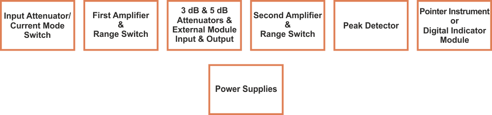

The block diagram of the instrument is shown in Figure 1.
Figure 1. | Block diagram of the wideband analog meter. |
The input attenuator/current mode selector is necessary since we want to measure voltages up to 100 V, and they can’t be applied directly to the amplifier. The current mode is selected so that there is no switch contact in series with the current-sensing resistor, thus eliminating a potential source of error. The small price to pay is that a separate connector is required for current-mode operation.
Using two op amps to reach gain
The amplifier requires a gain of around 1000 (60 dB) to give a full-scale reading for 1 mV input. This is achieved by using the two op amps in the LM4562, with gains of 31.62 each. The LM4562 is actually intended for hi-fi preamps, so it has low noise and low distortion, together with a wide bandwidth. It isn’t so hot on offset voltage, but that can be overcome in this application.
Since there are two amplifier stages, it is easy to provide connectors and switching so that other circuits can be inserted between the two amplifiers, and they can also be used as independent amplifiers if a further connector is added at the output of the second amplifier.
