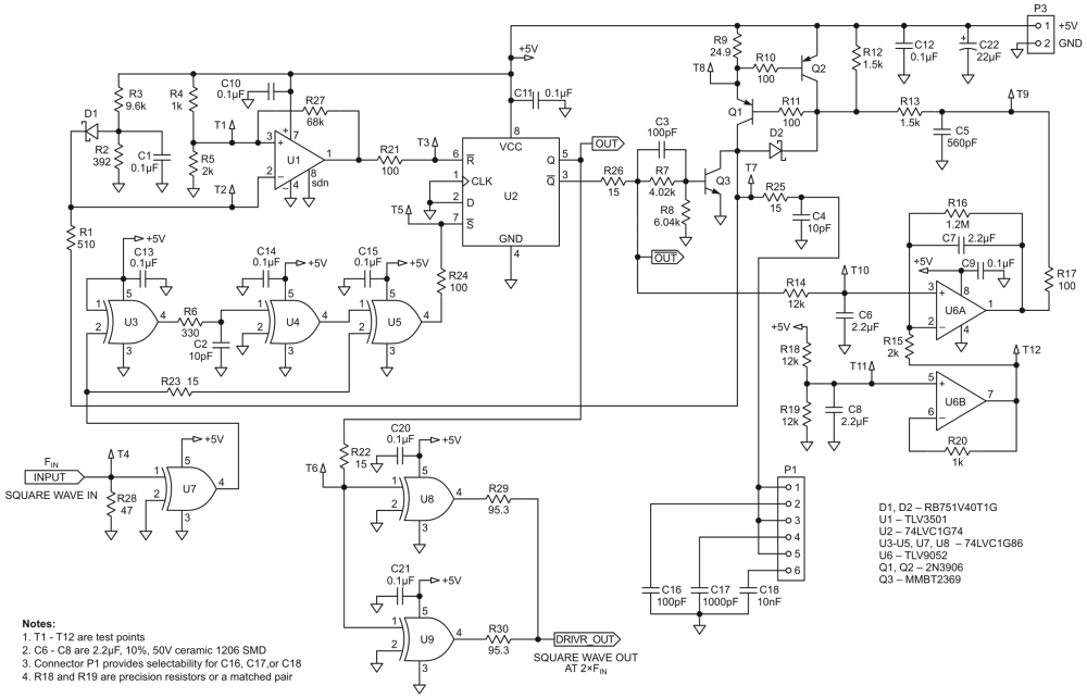

A simple description of the operation of the circuit: An ultra-fast one-shot is forced by negative feedback to produce a 50% duty cycle square wave output. I added a 50-ohm termination and a buffer/squarer at the input and a 50-ohm driver at the output for convenience in testing.
The nitty-gritty description (Figure 1): A 50% duty cycle square wave is the input to the XOR gate, U3 (via U7), causing a 2 ns pulse output from U5 to be applied to the /S input of the flip-flop, U2. The /Q output of the flip-flop goes low and turns off the discharge transistor, Q3, which allows the timing capacitor, C4, to begin charging. The output from Q3 is a voltage ramp which is applied through R1 to the inverting input of comparator, U1. The output of the comparator goes low when the voltage ramp reaches the reference voltage set by R4 and R5. This resets the flip-flop, causing the discharge transistor to turn on and discharge the timing capacitor, C4, and the cycle repeats.
Circuit for an ultra-fast one-shot is forced by negative feedback to produce a 50% duty cycle square wave output.
Figure 1. Circuit for an ultra-fast one-shot is forced by negative feedback to produce a 50% duty cycle square wave output.
The charging current to C4 is supplied by Q1 and the associated components. The charging current is controlled by negative feedback from op amp U6A, which forces the one-shot to produce a square wave of 50% duty cycle, which, when low-pass filtered, produces a DC voltage of exactly 2.5 V (if the supply voltage is exactly 5 V). The tolerances of R18 and R19 will determine how exact this voltage is.
The reference voltage provided by U6B and its associated components is set to 2.5 V by precision (or matched) resistors R18 and R19. This reference will track the +5 V supply, so that the 50% duty cycle square wave output of the circuit remains at 50% if the supply voltage changes. (The lightly loaded output of the flip-flip also tracks changes in the supply voltage.)

I used LTspice to design and simulate the circuit. Then I used Express PCB’s free tools to design and lay out a two-sided circuit board with a ground plane on the bottom side. I used AppCad, which is freely available on the web, to simulate the signal’s overshoot/undershoot on critical traces. I inserted resistors in series with some of the longer traces for fast signals to reduce overshoot/undershoot. I used surface mount devices for all of the components except Q1, Q2, the input and output SMA connectors, and connecter P1 and P3. (P2 was not used.) The points marked T1 through T12 are test points (plated-thru holes on the PCB). The loaded circuit board is shown in Figure 2.
