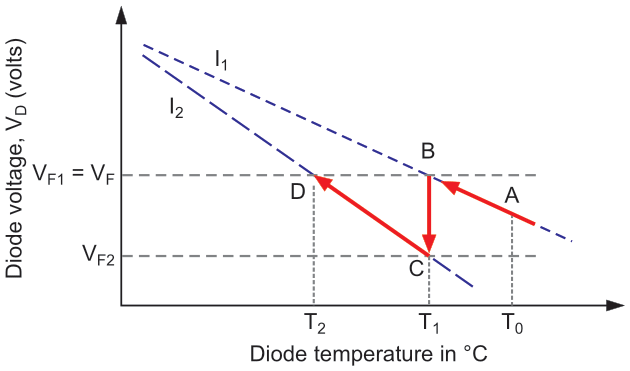

Figure 1 shows the effect of the two currents on the diode voltage as it is cooled in a water bath from temperature T0. In principle, the segments AB and CD extrapolated backwards meet at absolute zero (–273 °C). However, impurity and other effects in the diode limit circuit usefulness to about –200 °C.

At temperature T the use of two sequentially switched currents gives the data pair: (T, I1, V1), and (T, I2, V2). Putting the pair into Shockley’s equation allows the difference voltage ΔV = V1(T) – V2(T) to be found easily in terms of the ideality factor as
The ideality factor is typically constant for a given diode, being 1.9 for the 1N4148 diode [1]. Observed circuit predictability is better for silicon diodes than germanium diodes. In the last equation, the terms n, q/kT and ln(I1/I2) being constant, one can rewrite using a new constant b:
ΔV(T) = bT, where T is in Kelvin

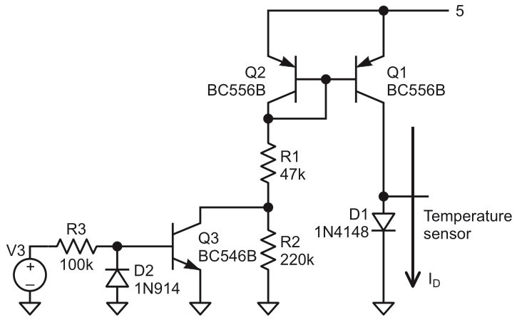

Therefore the voltage difference at a given temperature T is directly proportional to the temperature provided that the currents are switched in ratio at the measurement temperature. The switchover time is shorter than the time over which the temperature can change. For higher measurement accuracy the voltage difference ΔV at the temperature of interest should be large. Figure 1 suggests a large ratio I1/I2, but self heating could arise if I1 is made too large. Figure 2 shows an innovative, switched constant-current mirror made up of transistors Q1 and Q2 with the output current mirrored in D1.

In Figure 2 the load resistor of Q2 is switched into or out of the collector by an extra transistor, Q3 driven by a clock source V3 having 50% duty cycle. Thus the load resistance variably has the value R1 when V3 = 5 V and (R1 + R2) when V3 = 0 V. The values shown give two mirror currents of 20.14 µA or 111.38 µA. Substituting all the constants into the voltage difference equation gives

In the final circuit the clock source can be a 555-astable with near 50% duty-cycle, or an embedded controller PWM output. A design was tested at 10 kHz. The diode voltage switches between V1 and V2 and therefore has an inherent dc level that can filtered using a simple RC-network with a low cut-off frequency, e.g., 2 Hz if needed.
Filtering guarantees square-wave output with negligible peak level attenuation without introducing frequency dependence. The output can then be readout at “OUT1” in Figure 3 on a true RMS digital voltmeter in AC mode.
