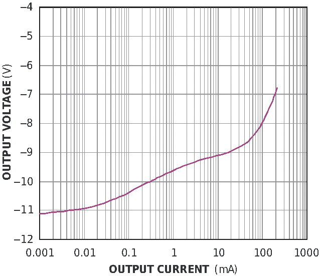

where VIN is the input voltage, VD is a diode's forward-voltage drop, IOUT is the output current, and RO is IC1 's output resistance in free-running mode. For a 300-µA load current, the circuit's output voltage is –10 V. Parasitic inductances inherent in the capacitors and pc-board traces produce a voltage overshoot that charges the output capacitors, delivering more than –11 V at no load (Figure 2).
At light loads, the circuit in Figure 1 delivers more than -10 V; at higher currents, the magnitude of the negative output voltage exceeds its positive input voltage of 5 V.
Figure 2. At light loads, the circuit in Figure 1 delivers more than –10 V; at higher currents,
