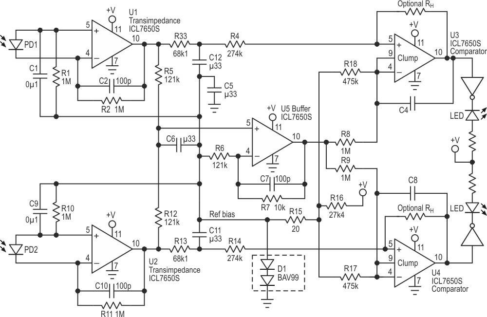

At first it seemed a simple approach – apply the photodiode signals to a chopper stabilized analog comparator to determine direction. However, this had a small problem. If there were bi-directional signals in a fiber such as used in coarse-wavelength multiplexing (1310 nm and 1550 nm propagating in opposite directions), we wanted both direction indicator LEDs to light up.  This of course cannot be done with a one-of-two-states comparator.
The circuit of Figure 1 gets around this problem by lighting only the appropriate direction indicator LED when there is a large difference between the two signal levels or when one signal is non-existent, but lights both LEDs when the photodiodes respond with signal levels closer together. The desired thresholds are dependent on the mechanical design of the optical clamp which is beyond the scope of this DI. If no signals are present in either direction, both LEDs remain off to indicate a dark fiber.
Analog comparator recognizes three signal relations
Figure 1. Since the optical levels need to be averaged to a DC value, the capacitors serve to remove data and test tone modulation
from the detected optical signals. C2, C7, and C10 ensure op amp stability. C4 and C8 are optional to slow flicker when
the comparators U3 and U4 are close to their switching thresholds; alternatively, positive feedback resistors RH can be
used instead for a hard switchover with no LED flicker. If required to prevent op amp saturation for very strong optical
signals, R2 and R11 can be reduced as necessary.
ICL7650S chopper stabilized op amps are used in this example as per the original hardware when this was in production (Figure 1 omits the necessary external stabilizing capacitors for clarity) – other types of op amps may be used. An approximate 1 V bias is set up through series diodes D1 as the zero-signal reference. R15 maintains both comparators U3 and U4 low with about +2 mV offset from this reference if there are no input signals present.
The circuit operation is straightforward. Each photodiode operating in photovoltaic mode drives the outputs of the corresponding transimpedance amplifiers U1 and U2 to a voltage depending on the intensity of the detected light. Each voltage is then applied to its corresponding comparator U3 and U4. The comparison voltage level is derived by combining the outputs of the transimpedance amplifiers through buffer U5 with slightly greater than unity gain. Therefore this level follows the maximum photodiode level divided by the minimum photodiode level through the voltage division of R5 and R12 to accommodate a wide variation in signal levels within the optical fiber. With the resistor values shown, both signals will indicate active as long as the lower photodiode current is not less than about 0.22x the larger photodiode current. Below this only the strongest signal will light its corresponding LED.

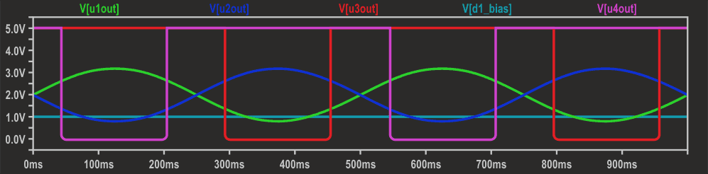

Figure 2. This simulation shows both photodiodes with a DC offset current of 0.5 µA (2 V on the left scale) and ±0.6 µA variation
to demonstrate the comparator responses with the resistor values shown in Figure 1. Reducing the values of R8 and R9
will narrow the both-on range; reducing R6 and R17 will widen the both-on range.
