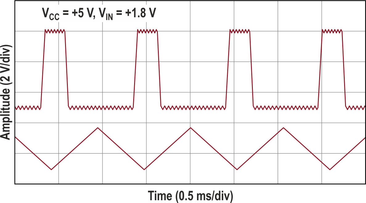

These waveforms show the circuit's PWM and triangular-wave outputs.
Figure 2. These waveforms show the circuit's PWM and triangular-wave outputs.
U1c compares the triangular wave against the dc level VIN. Its output is a square wave, with a duty cycle that varies from 0 to 100% as VIN varies from 0.25 VCC to 0.75 VCC (Fig. 2). Frequency is determined by R, C, R1, and R2:
