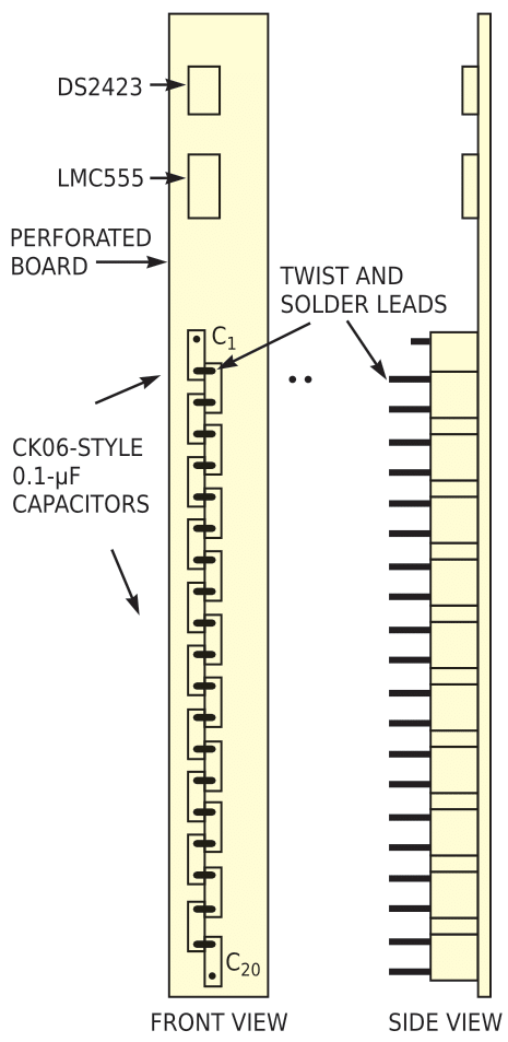

Figure 2 shows one method of fabricating the sensor. You epoxy-bond a series string of N radial-leaded ceramic capacitors of equal value C underneath a pc board. Twist the leads of adjacent capacitors, solder them together, and trim them to serve as electrodes to contact the water. The outer shell of the sensor, a piece of 0.75 in. copper pipe, forms another electrode. If you place this assembly vertically in a vessel, the capacitance between the terminals of the sensor (the uppermost lead of C1 and the outer shell) increases in steps as the water rises and covers more of the capacitors. The water effectively short-circuits the capacitors to the outer-shell electrode. Because the capacitors are in series, the total capacitance changes according to:

A string of series-connected capacitors provides an indication of water level.
Figure 2. A string of series-connected capacitors provides
This application uses 20 0.1 µF, CK06-style capacitors. The lead spacing of these capacitors is 0.2 in. These dimensions provide a measurement range of 4 in. with a resolution of 0.2 in. This design uses 1 MΩ for the oscillator timing resistor, RC, because the timing resistance must be much larger than the impedance of the water to minimize timing error. (Measurements of several municipal and residential well-water samples revealed impedance values of approximately 5 kΩ in the frequency of 5 Hz to 1 kHz with 0.5 in. probe spacing.) Another reason for 1 MΩ oscillator timing is that the DS2423 counter has a maximum input frequency of approximately 2 kHz. Also, you must minimize the power stolen from the bus. Finally, you must maintain maximum isolation of the water from the bus in the event of a catastrophic bus fault.
With these values of capacitance and resistance, the sensor's output-frequency range is approximately 7 to 142 Hz in steps of approximately 7 Hz. In practice, you might read the counter at intervals of several seconds to several minutes to obtain an averaging effect. This sensor has found application for two summers in a residential swimming pool.
