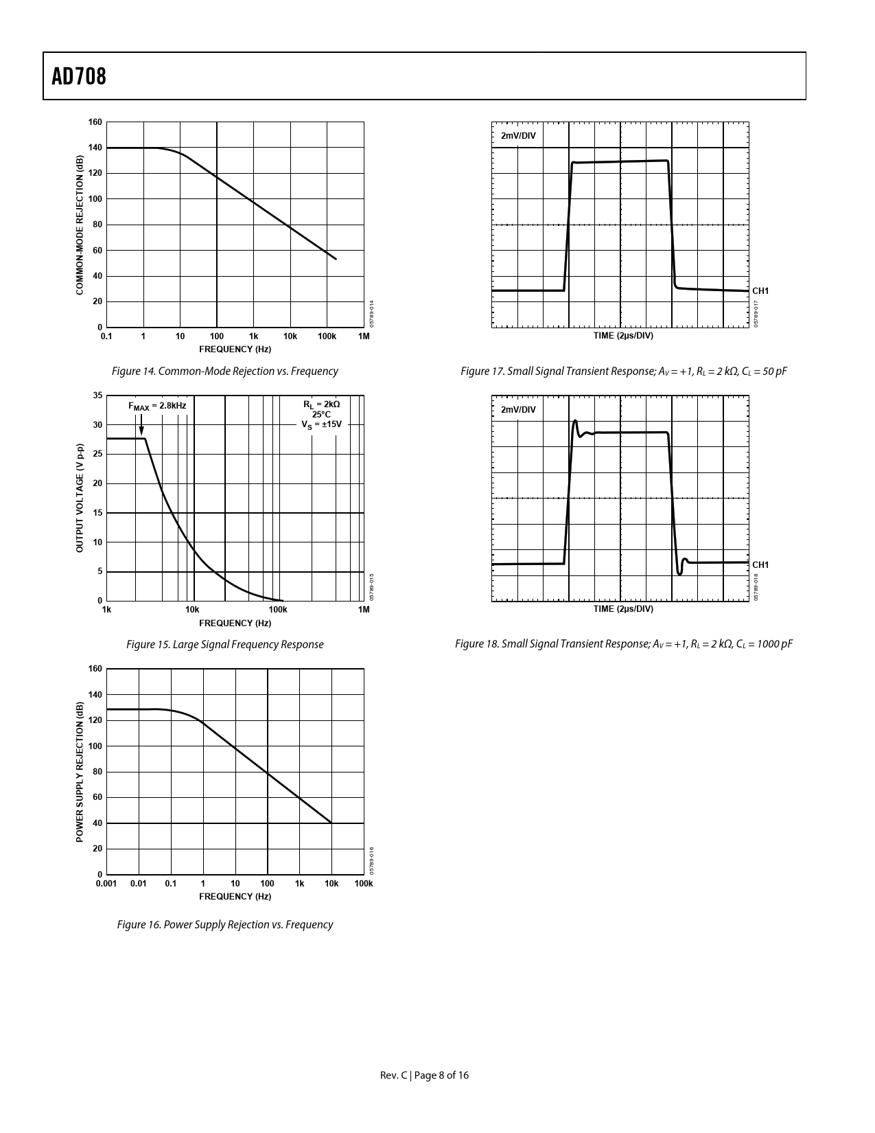

Pages / Page17 / 9 — AD708. 160. 2mV/DIV. 140. ) B d 120. N ( IO CT 100 JE RE. DE O -M. N O M. …

AD708. 160. 2mV/DIV. 140. ) B d 120. N ( IO CT 100 JE RE. DE O -M. N O M. M CO. CH1. 0.1. 100. 10k. 100k. TIME (2µs/DIV). FREQUENCY (Hz). FMAX = 2.8kHz
AD708 160 2mV/DIV 140 ) B d 120 N ( IO CT 100 JE RE DE O -M N O M M CO CH1 0.1 100 10k 100k TIME (2µs/DIV) FREQUENCY (Hz) FMAX = 2.8kHz
AD708 160 2mV/DIV 140 ) B d 120 N ( IO CT 100 JE RE 80 DE O -M 60 N O M 40 M CO CH1 20

0.1 1 10 100 1k 10k 100k 1M TIME (2µs/DIV) FREQUENCY (Hz)
Figure 14. Common-Mode Rejection vs. Frequency Figure 17. Small Signal Transient Response; AV = +1, RL = 2 kΩ, CL = 50 pF
35 FMAX = 2.8kHz RL = 2kΩ 2mV/DIV 25°C 30 VS = ±15V ) -p 25 p V ( E 20 AG T L O 15 V UT P UT 10 O CH1 5
Figure 15. Large Signal Frequency Response Figure 18. Small Signal Transient Response; AV = +1, RL = 2 kΩ, CL = 1000 pF
160 140 B) d 120 N ( IO T C 100 JE RE 80 Y L P P U 60 R S E 40 W O P 20

0.001 0.01 0.1 1 10 100 1k 10k 100k FREQUENCY (Hz)
Figure 16. Power Supply Rejection vs. Frequency Rev. C | Page 8 of 16 Document Outline FEATURES PIN CONFIGURATION GENERAL DESCRIPTION PRODUCT HIGHLIGHTS TABLE OF CONTENTS REVISION HISTORY SPECIFICATIONS ABSOLUTE MAXIMUM RATINGS ESD CAUTION TYPICAL PERFORMANCE CHARACTERISTICS THEORY OF OPERATION CROSSTALK PERFORMANCE OPERATION WITH A GAIN OF −100 HIGH PRECISION PROGRAMMABLE GAIN AMPLIFIER BRIDGE SIGNAL CONDITIONER PRECISION ABSOLUTE VALUE CIRCUIT SELECTION OF PASSIVE COMPONENTS OUTLINE DIMENSIONS ORDERING GUIDE
