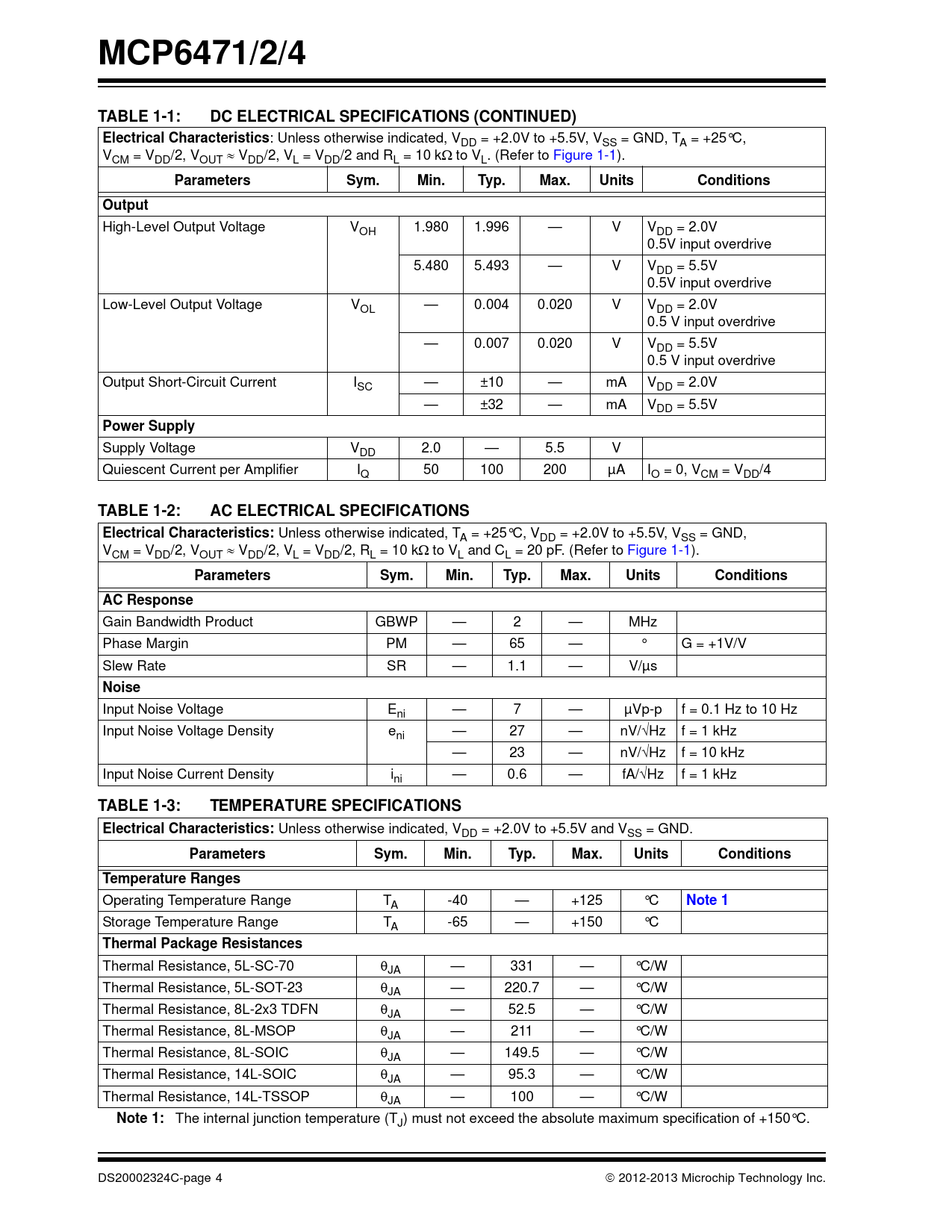

MCP6471/2/4. TABLE 1-1:. DC ELECTRICAL SPECIFICATIONS (CONTINUED). Electrical Characteristics. Parameters. Sym. Min. Typ. Max. Units
MCP6471/2/4 TABLE 1-1: DC ELECTRICAL SPECIFICATIONS (CONTINUED) Electrical Characteristics Parameters Sym Min Typ Max Units
link to page 5 link to page 4
: Unless otherwise indicated, VDD = +2.0V to +5.5V, VSS = GND, TA = +25°C, V  CM = VDD/2, VOUT VDD/2, VL = VDD/2 and RL = 10 kto VL. (Refer to Figure 1-1).
Parameters Sym. Min. Typ. Max. Units Conditions Output
High-Level Output Voltage VOH 1.980 1.996 — V VDD = 2.0V 0.5V input overdrive 5.480 5.493 — V VDD = 5.5V 0.5V input overdrive Low-Level Output Voltage VOL — 0.004 0.020 V VDD = 2.0V 0.5 V input overdrive — 0.007 0.020 V VDD = 5.5V 0.5 V input overdrive Output Short-Circuit Current ISC — ±10 — mA VDD = 2.0V — ±32 — mA VDD = 5.5V
Power Supply
Supply Voltage VDD 2.0 — 5.5 V Quiescent Current per Amplifier IQ 50 100 200 µA IO = 0, VCM = VDD/4
TABLE 1-2: AC ELECTRICAL SPECIFICATIONS Electrical Characteristics:
Unless otherwise indicated, TA = +25°C, VDD = +2.0V to +5.5V, VSS = GND, V  CM = VDD/2, VOUT VDD/2, VL = VDD/2, RL = 10 kto VL and CL = 20 pF. (Refer to Figure 1-1).
Parameters Sym. Min. Typ. Max. Units Conditions AC Response
Gain Bandwidth Product GBWP — 2 — MHz Phase Margin PM — 65 — ° G = +1V/V Slew Rate SR — 1.1 — V/µs
Noise
Input Noise Voltage Eni — 7 — µVp-p f = 0.1 Hz to 10 Hz Input Noise Voltage Density eni — 27 — nV/Hz f = 1 kHz — 23 — nV/Hz f = 10 kHz Input Noise Current Density ini — 0.6 — fA/Hz f = 1 kHz
TABLE 1-3: TEMPERATURE SPECIFICATIONS Electrical Characteristics:
Unless otherwise indicated, VDD = +2.0V to +5.5V and VSS = GND.
Parameters Sym. Min. Typ. Max. Units Conditions Temperature Ranges
Operating Temperature Range TA -40 — +125 °C
Note 1
Storage Temperature Range TA -65 — +150 °C
Thermal Package Resistances
Thermal Resistance, 5L-SC-70 JA — 331 — °C/W Thermal Resistance, 5L-SOT-23 JA — 220.7 — °C/W Thermal Resistance, 8L-2x3 TDFN JA — 52.5 — °C/W Thermal Resistance, 8L-MSOP JA — 211 — °C/W Thermal Resistance, 8L-SOIC JA — 149.5 — °C/W Thermal Resistance, 14L-SOIC JA — 95.3 — °C/W Thermal Resistance, 14L-TSSOP JA — 100 — °C/W
