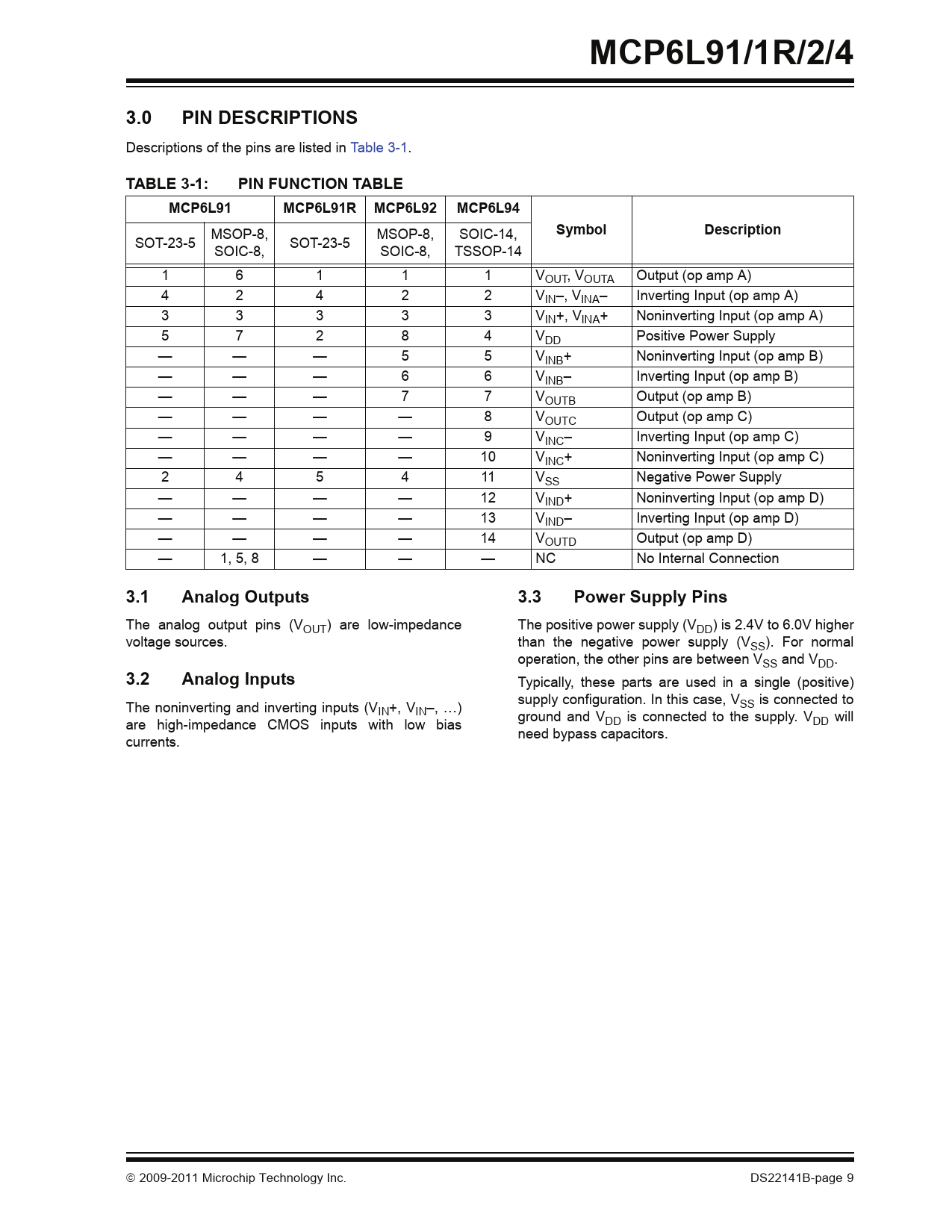

MCP6L91/1R/2/4 3.0 PIN DESCRIPTIONS
Descriptions of the pins are listed in Table 3-1.
TABLE 3-1: PIN FUNCTION TABLE MCP6L91 MCP6L91R MCP6L92 MCP6L94 Symbol Description
MSOP-8, MSOP-8, SOIC-14, SOT-23-5 SOT-23-5 SOIC-8, SOIC-8, TSSOP-14 1 6 1 1 1 VOUT, VOUTA Output (op amp A) 4 2 4 2 2 VIN–, VINA– Inverting Input (op amp A) 3 3 3 3 3 VIN+, VINA+ Noninverting Input (op amp A) 5 7 2 8 4 VDD Positive Power Supply — — — 5 5 VINB+ Noninverting Input (op amp B) — — — 6 6 VINB– Inverting Input (op amp B) — — — 7 7 VOUTB Output (op amp B) — — — — 8 VOUTC Output (op amp C) — — — — 9 VINC– Inverting Input (op amp C) — — — — 10 VINC+ Noninverting Input (op amp C) 2 4 5 4 11 VSS Negative Power Supply — — — — 12 VIND+ Noninverting Input (op amp D) — — — — 13 VIND– Inverting Input (op amp D) — — — — 14 VOUTD Output (op amp D) — 1, 5, 8 — — — NC No Internal Connection
3.1 Analog Outputs 3.3 Power Supply Pins
The analog output pins (VOUT) are low-impedance The positive power supply (VDD) is 2.4V to 6.0V higher voltage sources. than the negative power supply (VSS). For normal operation, the other pins are between VSS and VDD.
3.2 Analog Inputs
Typically, these parts are used in a single (positive) supply configuration. In this case, V The noninverting and inverting inputs (V SS is connected to IN+, VIN–, …) are high-impedance CMOS inputs with low bias ground and VDD is connected to the supply. VDD wil need bypass capacitors. currents.  2009-2011 Microchip Technology Inc. DS22141B-page 9 Document Outline 1.0 Electrical Characteristics 1.1 Absolute Maximum Ratings † 1.2 Specifications TABLE 1-1: DC Electrical Specifications TABLE 1-2: AC Electrical Specifications TABLE 1-3: Temperature Specifications 1.3 Test Circuit FIGURE 1-1: AC and DC Test Circuit for Most Specifications. 2.0 Typical Performance Curves FIGURE 2-1: Input Offset Voltage vs. Common Mode Input Voltage at VDD = 2.4V. FIGURE 2-2: Input Offset Voltage vs. Common Mode Input Voltage at VDD = 5.5V. FIGURE 2-3: Input Offset Voltage vs. Output Voltage. FIGURE 2-4: Input Common Mode Range Voltage vs. Ambient Temperature. FIGURE 2-5: CMRR, PSRR vs. Ambient Temperature. FIGURE 2-6: CMRR, PSRR vs. Frequency. FIGURE 2-7: Measured Input Current vs. Input Voltage (below VSS). FIGURE 2-8: Open-Loop Gain, Phase vs. Frequency. FIGURE 2-9: Input Noise Voltage Density vs. Frequency. FIGURE 2-10: The MCP6L91/1R/2/4 Show No Phase Reversal. FIGURE 2-11: Quiescent Current vs. Power Supply Voltage. FIGURE 2-12: Output Short Circuit Current vs. Power Supply Voltage. FIGURE 2-13: Ratio of Output Voltage Headroom to Output Current vs. Output Current. FIGURE 2-14: Small Signal, Noninverting Pulse Response. FIGURE 2-15: Large Signal, Noninverting Pulse Response. FIGURE 2-16: Slew Rate vs. Ambient Temperature. FIGURE 2-17: Output Voltage Swing vs. Frequency. 3.0 Pin Descriptions TABLE 3-1: Pin Function Table 3.1 Analog Outputs 3.2 Analog Inputs 3.3 Power Supply Pins 4.0 Application Information 4.1 Rail-to-Rail Inputs FIGURE 4-1: Protecting the Analog Inputs. 4.2 Rail-to-Rail Output 4.3 Capacitive Loads FIGURE 4-2: Output Resistor, RISO stabilizes large capacitive loads. 4.4 Supply Bypass 4.5 Unused Op Amps FIGURE 4-3: Unused Op Amps. 4.6 PCB Surface Leakage FIGURE 4-4: Example Guard Ring Layout. 4.7 Application Circuit FIGURE 4-5: Chebyshev Filter. 5.0 Design Aids 5.1 SPICE Macro Model 5.2 FilterLab® Software 5.3 Microchip Advanced Part Selector (MAPS) 5.4 Analog Demonstration and Evaluation Boards 5.5 Application Notes 6.0 Packaging Information 6.1 Package Marking Information Appendix A: Revision History Product ID System Trademarks Worldwide Sales
