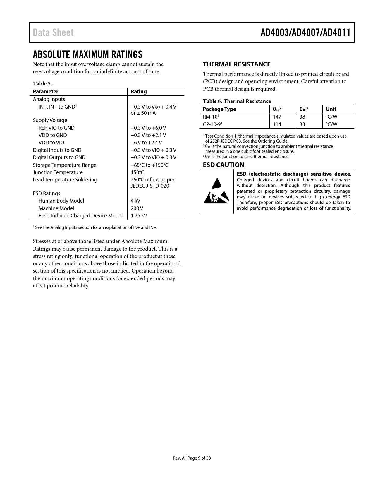

Data Sheet. AD4003/AD4007/AD4011. ABSOLUTE MAXIMUM RATINGS. THERMAL RESISTANCE. Table 5. Parameter. Rating
Data Sheet AD4003/AD4007/AD4011 ABSOLUTE MAXIMUM RATINGS THERMAL RESISTANCE Table 5 Parameter Rating
link to page 20 link to page 38
Note that the input overvoltage clamp cannot sustain the
THERMAL RESISTANCE
overvoltage condition for an indefinite amount of time. Thermal performance is directly linked to printed circuit board
Table 5.
(PCB) design and operating environment. Careful attention to
Parameter Rating
PCB thermal design is required. Analog Inputs
Table 6. Thermal Resistance
IN+, IN− to GND1 −0.3 V to VREF + 0.4 V
Package Type θ 2 θ 3 Unit
or ± 50 mA
JA JC
RM-101 147 38 °C/W Supply Voltage CP-10-91 114 33 °C/W REF, VIO to GND −0.3 V to +6.0 V VDD to GND −0.3 V to +2.1 V 1 Test Condition 1: thermal impedance simulated values are based upon use VDD to VIO −6 V to +2.4 V of 2S2P JEDEC PCB. See the Ordering Guide. 2 θ Digital Inputs to GND −0.3 V to VIO + 0.3 V JA is the natural convection junction to ambient thermal resistance measured in a one cubic foot sealed enclosure. Digital Outputs to GND −0.3 V to VIO + 0.3 V 3 θJC is the junction to case thermal resistance. Storage Temperature Range −65°C to +150°C
