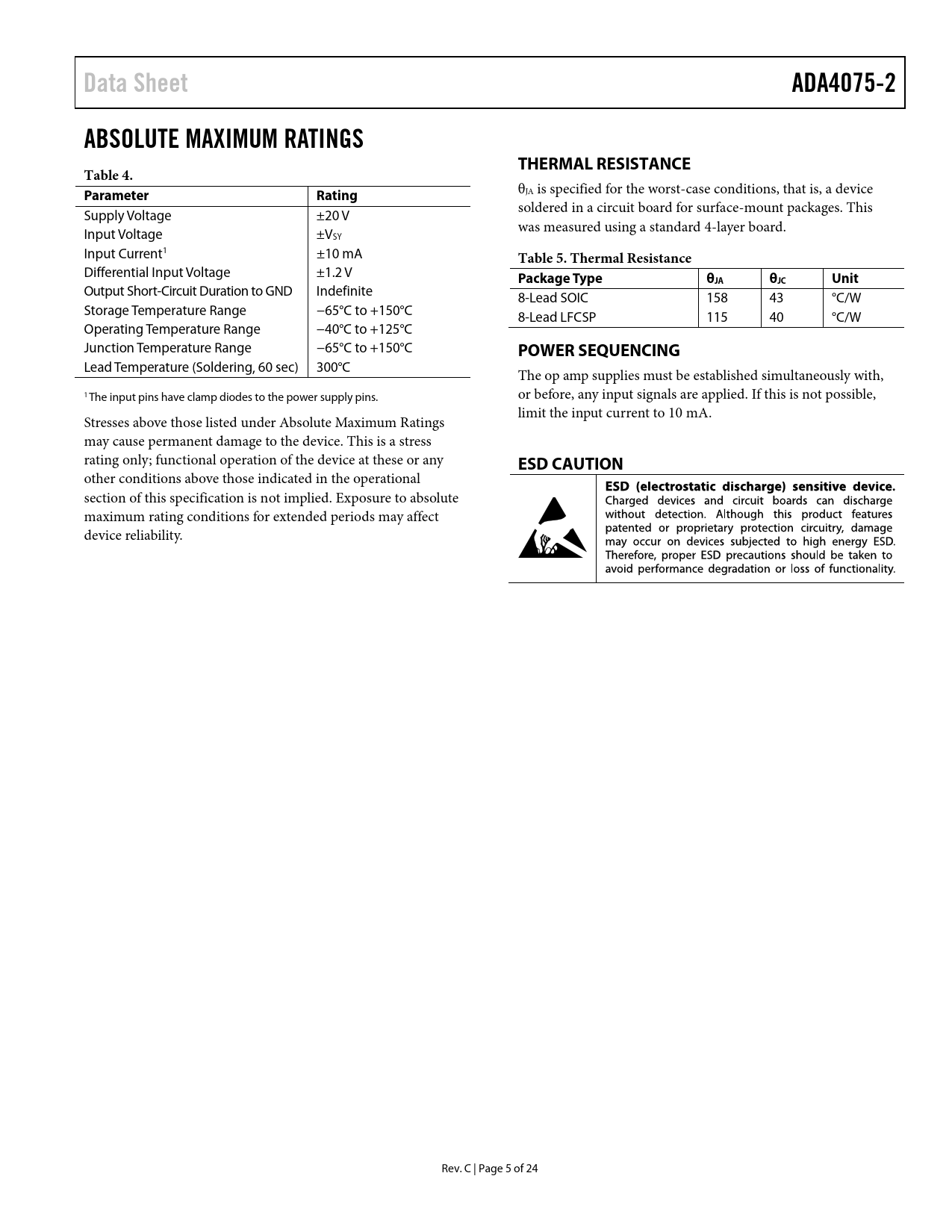

Data Sheet. ADA4075-2. ABSOLUTE MAXIMUM RATINGS. THERMAL RESISTANCE. Table 4. Parameter. Rating. Table 5. Thermal Resistance
Data Sheet ADA4075-2 ABSOLUTE MAXIMUM RATINGS THERMAL RESISTANCE Table 4 Parameter Rating Table 5 Thermal Resistance
link to page 6
Data Sheet ADA4075-2 ABSOLUTE MAXIMUM RATINGS THERMAL RESISTANCE Table 4. Parameter Rating
θJA is specified for the worst-case conditions, that is, a device Supply Voltage ±20 V soldered in a circuit board for surface-mount packages. This Input Voltage ±V was measured using a standard 4-layer board. SY Input Current1 ±10 mA
Differential Input Voltage ±1.2 V
Package Type θJA θJC Unit
Output Short-Circuit Duration to GND Indefinite 8-Lead SOIC 158 43 °C/W Storage Temperature Range −65°C to +150°C 8-Lead LFCSP 115 40 °C/W Operating Temperature Range −40°C to +125°C Junction Temperature Range −65°C to +150°C
POWER SEQUENCING
Lead Temperature (Soldering, 60 sec) 300°C The op amp supplies must be established simultaneously with, 1 The input pins have clamp diodes to the power supply pins. or before, any input signals are applied. If this is not possible, Stresses above those listed under Absolute Maximum Ratings limit the input current to 10 mA. may cause permanent damage to the device. This is a stress rating only; functional operation of the device at these or any
