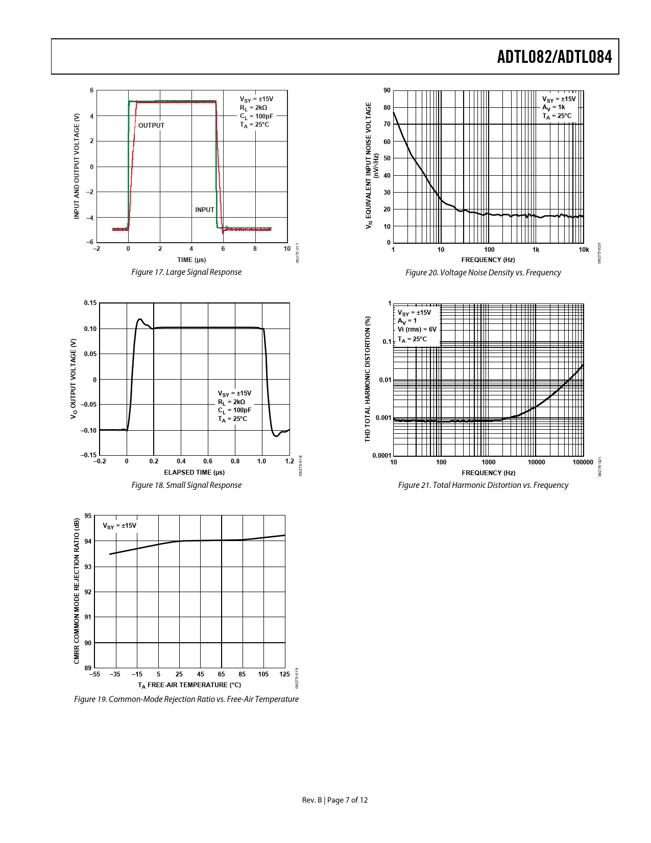

ADTL082/ADTL084. VSY = ±15V. RL = 2kΩ. AV = 1k. CL = 100pF. A = 25°C. OUTPUT. TA = 25°C. AG T. UT P. √Hz. (n 40. EN L. AND O UT. IVA. INPUT. E NV 10. 100
ADTL082/ADTL084 VSY = ±15V RL = 2kΩ AV = 1k CL = 100pF A = 25°C OUTPUT TA = 25°C AG T UT P √Hz (n 40 EN L AND O UT IVA INPUT E NV 10 100
ADTL082/ADTL084 6 90 VSY = ±15V VSY = ±15V E RL = 2kΩ G 80 AV = 1k ) A V 4 CL = 100pF T T ( A = 25°C L E OUTPUT TA = 25°C 70 VO AG T E 2 L IS 60 O O V N ) T 50 UT P 0 PU √Hz N V/ UT I (n 40 T –2 EN L 30 AND O UT IVA P INPUT U 20 Q IN –4 E NV 10 –6 0 –2 0 2 4 6 8 10
17 20 0
1 10 100 1k 10k
0 5- 5-
TIME (µs)
27
FREQUENCY (Hz)
27 06 06 Figure 17. Large Signal Response Figure 20. Voltage Noise Density vs. Frequency
0.15 1 VSY = ±15V ) % AV = 1 0.10 N ( Vi (rms) = 6V ) IO T V 0.1 A = 25°C ( RT E 0.05 O T AG S T L O C DI V 0 NI 0.01 O UT P VSY = ±15V UT –0.05 RL = 2kΩ HARM O C O L = 100pF AL V T T 0.001 A = 25°C O –0.10 HD T T –0.15
8
0.0001
1
–0.2 0 0.2 0.4 0.6 0.8 1.0 1.2
01
10 100 1000 10000 100000
02 5- 5-
ELAPSED TIME (µs)
27
FREQUENCY (Hz)
27 06 06 Figure 18. Small Signal Response Figure 21. Total Harmonic Distortion vs. Frequency
95 ) B d VSY = ±15V ( IO 94 N RAT IO 93 CT JE RE 92 DE O N M 91 O M M 90 RR CO CM 89
9
–55 –35 –15 5 25 45 65 85 105 125
01 5-
T
27
A FREE-AIR TEMPERATURE (°C)
06 Figure 19. Common-Mode Rejection Ratio vs. Free-Air Temperature Rev. B | Page 7 of 12 Document Outline FEATURES APPLICATIONS PIN CONFIGURATIONS GENERAL DESCRIPTION TABLE OF CONTENTS REVISION HISTORY SPECIFICATIONS ABSOLUTE MAXIMUM RATINGS THERMAL RESISTANCE POWER SEQUENCING ESD CAUTION TYPICAL PERFORMANCE CHARACTERISTICS OUTLINE DIMENSIONS ORDERING GUIDE
