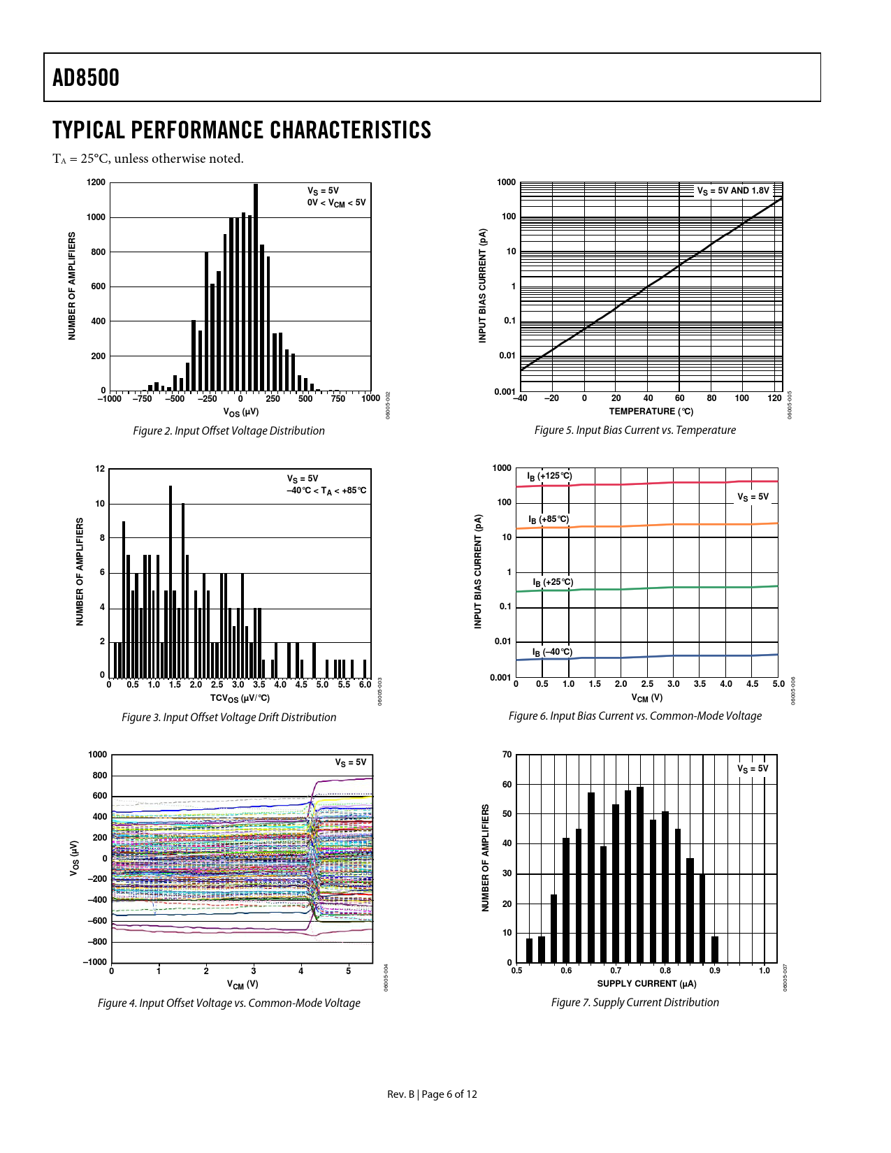

AD8500. TYPICAL PERFORMANCE CHARACTERISTICS. 1200. 1000. VS = 5V. VS = 5V AND 1.8V. 0V < VCM < 5V. 100. 800. L P. 600. CURRE S. R O. 400. 0.1
AD8500 TYPICAL PERFORMANCE CHARACTERISTICS 1200 1000 VS = 5V VS = 5V AND 1.8V 0V < VCM < 5V 100 800 L P 600 CURRE S R O 400 0.1
TA = 25°C, unless otherwise noted.
1200 1000 VS = 5V VS = 5V AND 1.8V 0V < VCM < 5V 1000 100 ) S A R p IE ( 800 10 IF NT L P AM 600 F 1 CURRE S R O IA BE B 400 0.1 UT NUM INP 200 0.01 0

–1000 –750 –500 –250 0 250 500 750 0 1 00
00
–40 –20 0 20 40 60 80 100 120

OS (µV) TEMPERATURE (°C)
06 06 Figure 2. Input Offset Voltage Distribution Figure 5. Input Bias Current vs. Temperature
12 1000 V I S = 5V B (+125°C) –40°C < TA < +85°C VS = 5V 10 100 S A) IB (+85°C) R p IE ( 8 T 10 IF N L P RRE AM 6 F 1 CU IB (+25°C) R O AS BE BI 4 T 0.1 U NUM INP 2 0.01 IB (–40°C) 0

0 0.5 1.0 1.5 2.0 2.5 3.0 3.5 4.0 4.5 5.0 5.5 6.0

OS (µV/°C) VCM (V)
06 06 Figure 3. Input Offset Voltage Drift Distribution Figure 6. Input Bias Current vs. Common-Mode Voltage
1000 70 VS = 5V VS = 5V 800 60 600 S 400 R 50 IE IF 200 L ) P V 40 M 0 A OSV OF 30 –200 R E B –400 M U 20 N –600 10 –800 –1000 0

0 1 2 3 4 5

0.5 0.6 0.7 0.8 0.9 1.0

CM (V) SUPPLY CURRENT (µA)
06 06 Figure 4. Input Offset Voltage vs. Common-Mode Voltage Figure 7. Supply Current Distribution Rev. B | Page 6 of 12 Document Outline FEATURES APPLICATIONS PIN CONFIGURATION GENERAL DESCRIPTION TABLE OF CONTENTS REVISION HISTORY SPECIFICATIONS ABSOLUTE MAXIMUM RATINGS THERMAL RESISTANCE ESD CAUTION TYPICAL PERFORMANCE CHARACTERISTICS OUTLINE DIMENSIONS ORDERING GUIDE
