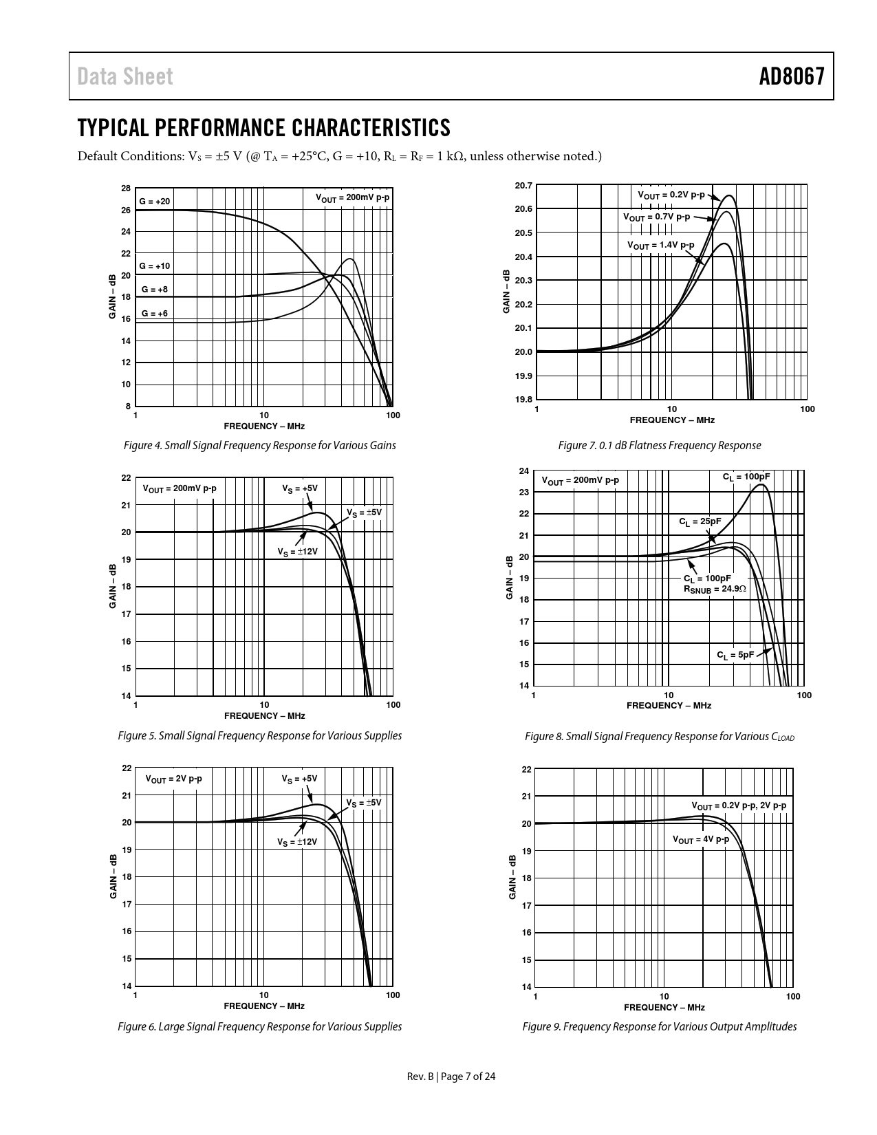

Data Sheet. AD8067. TYPICAL PERFORMANCE CHARACTERISTICS. 20.7. VOUT = 0.2V p-p. G = +20. VOUT = 200mV p-p. 20.6. VOUT = 0.7V p-p. 20.5
Data Sheet AD8067 TYPICAL PERFORMANCE CHARACTERISTICS 20.7 VOUT = 0.2V p-p G = +20 VOUT = 200mV p-p 20.6 VOUT = 0.7V p-p 20.5
Default Conditions: VS = ±5 V (@ TA = +25°C, G = +10, RL = RF = 1 kΩ, unless otherwise noted.)
28 20.7 VOUT = 0.2V p-p G = +20 VOUT = 200mV p-p 26 20.6 VOUT = 0.7V p-p 24 20.5 VOUT = 1.4V p-p 22 20.4 G = +10 20 dB 20.3 dB G = +8 18 20.2 GAIN GAIN G = +6 16 20.1 14 20.0 12 19.9 10 19.8 8 1 10 100 1 10 100 FREQUENCY – MHz FREQUENCY – MHz
Figure 4. Small Signal Frequency Response for Various Gains Figure 7. 0.1 dB Flatness Frequency Response
24 22 VOUT = 200mV p-p CL = 100pF VOUT = 200mV p-p VS = +5V 23 21 VS =
5V 22 CL = 25pF 20 21 VS =
12V 19 20 dB dB 19 CL = 100pF 18 RSNUB = 24.9
GAIN 18 GAIN 17 17 16 16 CL = 5pF 15 15 14 14 1 10 100 1 10 100 FREQUENCY – MHz FREQUENCY – MHz
Figure 5. Small Signal Frequency Response for Various Supplies Figure 8. Small Signal Frequency Response for Various CLOAD
22 22 VOUT = 2V p-p VS = +5V 21 21 VS =
5V VOUT = 0.2V p-p, 2V p-p 20 20 V V S =
12V OUT = 4V p-p 19 19 dB – dB – 18 18 GAIN GAIN 17 17 16 16 15 15 14 14 1 10 100 1 10 100 FREQUENCY – MHz FREQUENCY – MHz
Figure 6. Large Signal Frequency Response for Various Supplies Figure 9. Frequency Response for Various Output Amplitudes Rev. B | Page 7 of 24 Document Outline Features Applications Connection Diagram (Top View) General Description Revision History Specifications for ±5 V Specifications for +5 V Specifications for ±12 V Absolute Maximum Ratings Maximum Power Dissipation ESD Caution Typical Performance Characteristics Test Circuits Theory of Operation Basic Frequency Response Resistor Selection for Wideband Operation DC Error Calculations Input and Output Overload Behavior Input Protection Capacitive Load Drive Layout, Grounding, and Bypassing Considerations Layout Grounding Power Supply Bypassing Applications Wideband Photodiode Preamp Using the AD8067 at Gains of Less Than 8 Single-Supply Operation High Gain, High Bandwidth Composite Amplifier Outline Dimensions Ordering Guide
