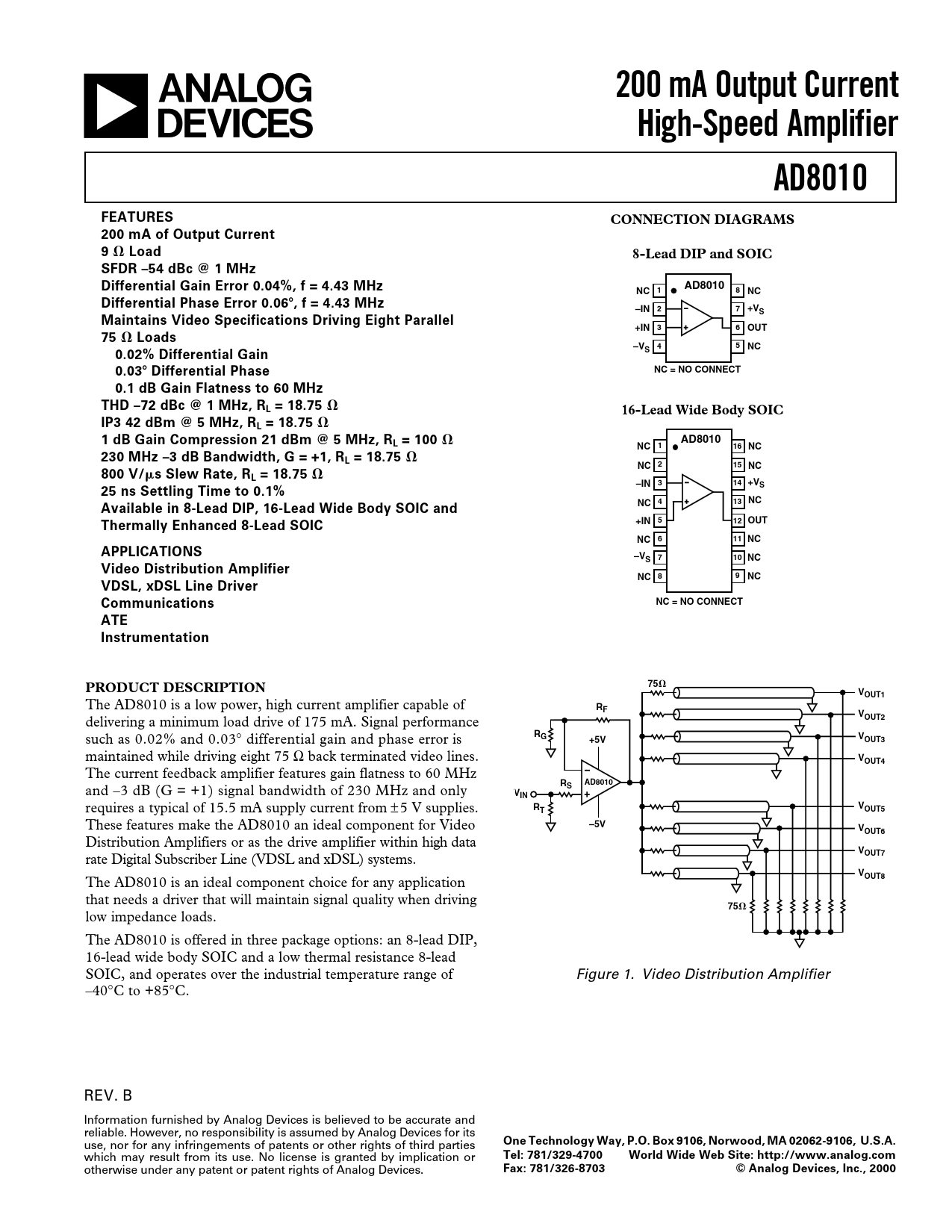

200 mA Output Current. High-Speed Amplifier. AD8010. FEATURES. CONNECTION DIAGRAMS. 200 mA of Output Current 9. Load
Datasheet AD8010 Analog Devices, Revision: B
a
200 mA Output Current High-Speed Amplifier AD8010 FEATURES CONNECTION DIAGRAMS 200 mA of Output Current 9 Load 8-Lead DIP and SOIC SFDR –54 dBc @ 1 MHz Differential Gain Error 0.04%, f = 4.43 MHz AD8010 1 NC 8 NC Differential Phase Error 0.06 , f = 4.43 MHz –IN 2 7 +VS Maintains Video Specifications Driving Eight Parallel +IN 3 6 OUT 75 Loads –V 4 5 NC S 0.02% Differential Gain NC = NO CONNECT 0.03 Differential Phase 0.1 dB Gain Flatness to 60 MHz THD –72 dBc @ 1 MHz, RL = 18.75 16-Lead Wide Body SOIC IP3 42 dBm @ 5 MHz, RL = 18.75 1 dB Gain Compression 21 dBm @ 5 MHz, R AD8010 L = 100 1 NC 16 NC 230 MHz –3 dB Bandwidth, G = +1, RL = 18.75 2 15 NC NC 800 V/ s Slew Rate, RL = 18.75 3 14 –IN +VS 25 ns Settling Time to 0.1% 4 13 NC NC Available in 8-Lead DIP, 16-Lead Wide Body SOIC and +IN 5 12 OUT Thermally Enhanced 8-Lead SOIC NC 6 11 NC APPLICATIONS –VS 7 10 NC Video Distribution Amplifier 8 9 NC NC VDSL, xDSL Line Driver NC = NO CONNECT Communications ATE Instrumentation 75 PRODUCT DESCRIPTION VOUT1
The AD8010 is a low power, high current amplifier capable of
RF VOUT2
delivering a minimum load drive of 175 mA. Signal performance
RG
such as 0.02% and 0.03° differential gain and phase error is
+5V VOUT3
maintained while driving eight 75 Ω back terminated video lines.
VOUT4
The current feedback amplifier features gain flatness to 60 MHz
R AD8010 S
and –3 dB (G = +1) signal bandwidth of 230 MHz and only
VIN
requires a typical of 15.5 mA supply current from
R V
±5 V supplies.
T OUT5 –5V
These features make the AD8010 an ideal component for Video
VOUT6
Distribution Amplifiers or as the drive amplifier within high data
VOUT7
rate Digital Subscriber Line (VDSL and xDSL) systems.
VOUT8
The AD8010 is an ideal component choice for any application that needs a driver that will maintain signal quality when driving
75
low impedance loads. The AD8010 is offered in three package options: an 8-lead DIP, 16-lead wide body SOIC and a low thermal resistance 8-lead SOIC, and operates over the industrial temperature range of Figure 1. Video Distribution Amplifier –40°C to +85°C. REV. B Information furnished by Analog Devices is believed to be accurate and reliable. However, no responsibility is assumed by Analog Devices for its use, nor for any infringements of patents or other rights of third parties
