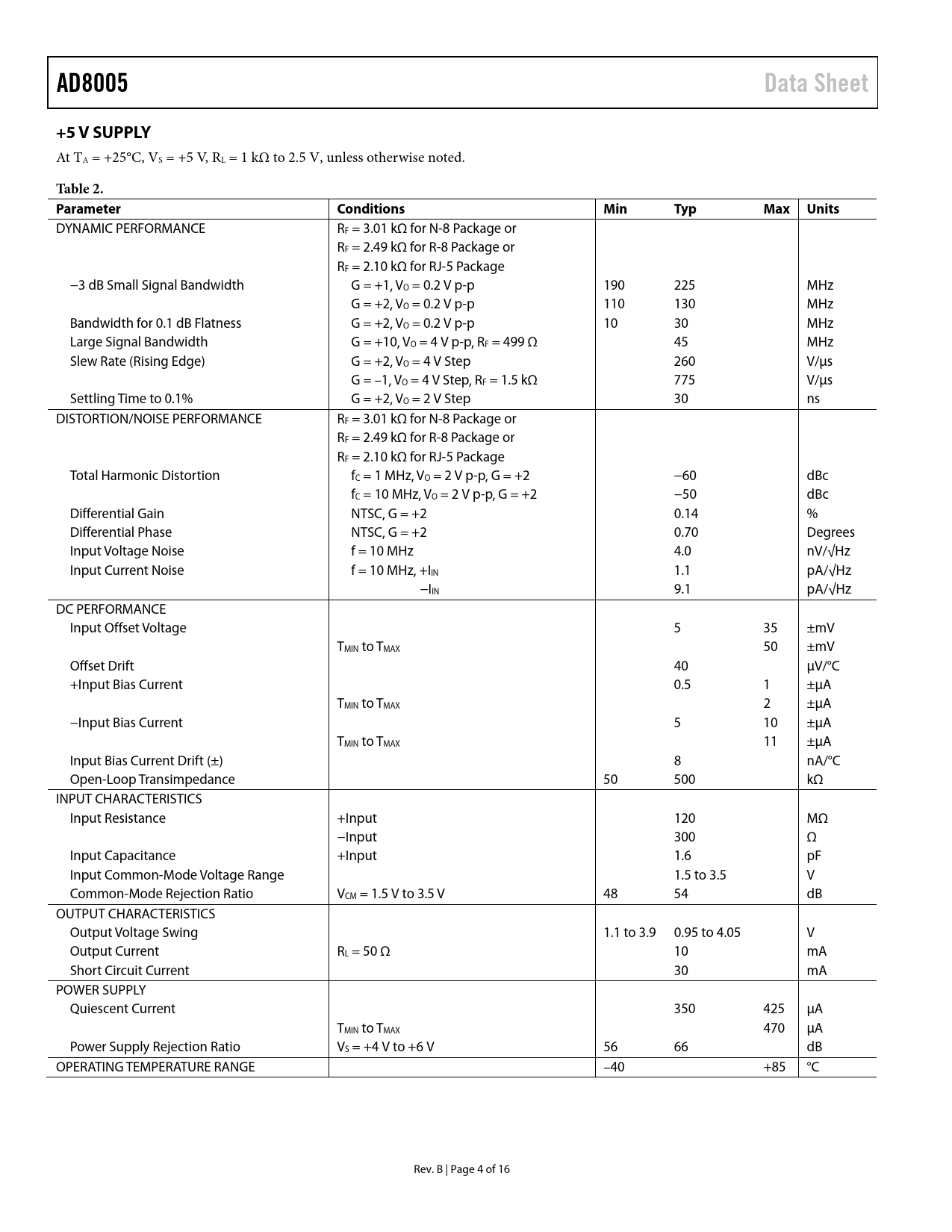

AD8005. Data Sheet. +5 V SUPPLY. Table 2. Parameter. Conditions. Min. Typ. Max Units
AD8005 Data Sheet +5 V SUPPLY Table 2 Parameter Conditions Min Typ Max Units
At TA = +25°C, VS = +5 V, RL = 1 kΩ to 2.5 V, unless otherwise noted.
Table 2. Parameter Conditions Min Typ Max Units
DYNAMIC PERFORMANCE RF = 3.01 kΩ for N-8 Package or RF = 2.49 kΩ for R-8 Package or RF = 2.10 kΩ for RJ-5 Package −3 dB Small Signal Bandwidth G = +1, VO = 0.2 V p-p 190 225 MHz G = +2, VO = 0.2 V p-p 110 130 MHz Bandwidth for 0.1 dB Flatness G = +2, VO = 0.2 V p-p 10 30 MHz Large Signal Bandwidth G = +10, VO = 4 V p-p, RF = 499 Ω 45 MHz Slew Rate (Rising Edge) G = +2, VO = 4 V Step 260 V/µs G = –1, VO = 4 V Step, RF = 1.5 kΩ 775 V/µs Settling Time to 0.1% G = +2, VO = 2 V Step 30 ns DISTORTION/NOISE PERFORMANCE RF = 3.01 kΩ for N-8 Package or RF = 2.49 kΩ for R-8 Package or RF = 2.10 kΩ for RJ-5 Package Total Harmonic Distortion fC = 1 MHz, VO = 2 V p-p, G = +2 −60 dBc fC = 10 MHz, VO = 2 V p-p, G = +2 −50 dBc Differential Gain NTSC, G = +2 0.14 % Differential Phase NTSC, G = +2 0.70 Degrees Input Voltage Noise f = 10 MHz 4.0 nV/√Hz Input Current Noise f = 10 MHz, +IIN 1.1 pA/√Hz −IIN 9.1 pA/√Hz DC PERFORMANCE Input Offset Voltage 5 35 ±mV TMIN to TMAX 50 ±mV Offset Drift 40 µV/°C +Input Bias Current 0.5 1 ±µA TMIN to TMAX 2 ±µA −Input Bias Current 5 10 ±µA TMIN to TMAX 11 ±µA Input Bias Current Drift (±) 8 nA/°C Open-Loop Transimpedance 50 500 kΩ INPUT CHARACTERISTICS Input Resistance +Input 120 MΩ −Input 300 Ω Input Capacitance +Input 1.6 pF Input Common-Mode Voltage Range 1.5 to 3.5 V Common-Mode Rejection Ratio VCM = 1.5 V to 3.5 V 48 54 dB OUTPUT CHARACTERISTICS Output Voltage Swing 1.1 to 3.9 0.95 to 4.05 V Output Current RL = 50 Ω 10 mA Short Circuit Current 30 mA POWER SUPPLY Quiescent Current 350 425 µA TMIN to TMAX 470 µA Power Supply Rejection Ratio VS = +4 V to +6 V 56 66 dB OPERATING TEMPERATURE RANGE –40 +85 °C Rev. B | Page 4 of 16 Document Outline Features Applications General Description Functional Block Diagrams Table of Contents Revision History Specifications ±5 V Supplies +5 V Supply Absolute Maximum Ratings Thermal Resistance Maximum Power Dissipation ESD Caution Typical Performance Characteristics Applications Driving Capicative Loads Single-Supply Level Shifter Single-Ended-to-Differential Conversion Layout Considerations Increasing Feedback Resistors Outline Dimensions Ordering Guide
