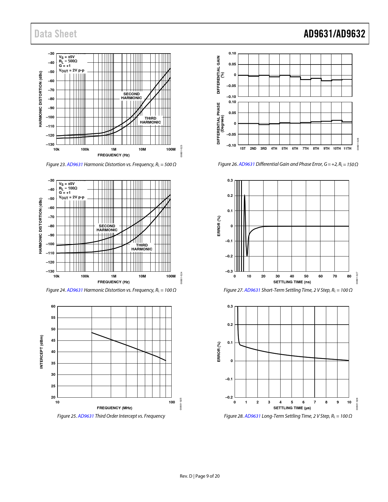

DescriptionUltralow Distortion, Wide Bandwidth Voltage Feedback Op Amp

00601- Figure 23. AD9631 Harmonic Distortion vs. Frequency, RL = 500 Ω Figure 26. AD9631 Differential Gain and Phase Error, G = +2, RL = 150 Ω
–30 0.3 VS = ±5V –40 RL = 100Ω G = +1 0.2 –50 VOUT = 2V p-p Bc) d –60 N ( 0.1 IO –70 RT %) O T R ( –80 S SECOND 0 HARMONIC RRO C DI –90 E NI O –0.1 –100 THIRD HARMONIC HARM –110 –0.2 –120 –130 –0.3 10k 100k 1M 10M 100M

00601- Figure 24. AD9631 Harmonic Distortion vs. Frequency, RL = 100 Ω Figure 27. AD9631 Short-Term Settling Time, 2 V Step, RL = 100 Ω
60 0.3 55 0.2 50 Bm) 45 d 0.1 ( %) T P R ( 40 RCE RRO E E 0 35 INT 30 –0.1 25 20 –0.2 10 100

00601- Figure 25. AD9631 Third Order Intercept vs. Frequency Figure 28. AD9631 Long-Term Settling Time, 2 V Step, RL = 100 Ω Rev. D | Page 9 of 20 Document Outline Features Applications General Description Pin Configuration Table of Contents Revision History Specifications Electrical Characteristics Absolute Maximum Ratings Metallization Photo Thermal Resistance Maximum Power Dissipation ESD Caution Typical Performance Characteristics Theory of Operation General Feedback Resistor Choice Pulse Response Large Signal Performance Power Supply Bypassing Driving Capacitive Loads Applications Information Operation as a Video Line Driver Active Filters Analog-to-Digital Converter (ADC) Driver Layout Considerations Outline Dimensions Ordering Guide
