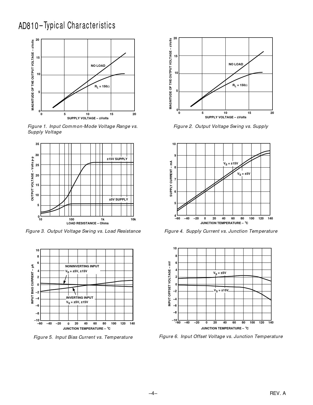

AD810–Typical Characteristics. NO LOAD. RL = 150. L = 150. MAGNITUDE OF THE OUTPUT VOLTAGE – ±Volts. SUPPLY VOLTAGE – ±Volts
AD810–Typical Characteristics NO LOAD RL = 150 L = 150 MAGNITUDE OF THE OUTPUT VOLTAGE – ±Volts SUPPLY VOLTAGE – ±Volts
AD810
AD810–Typical Characteristics 20 20 15 15 NO LOAD NO LOAD 10 10 R RL = 150
L = 150
5 5 MAGNITUDE OF THE OUTPUT VOLTAGE – ±Volts MAGNITUDE OF THE OUTPUT VOLTAGE – ±Volts 0 0 0 5 10 15 20 0 5 10 15 20 SUPPLY VOLTAGE – ±Volts SUPPLY VOLTAGE – ±Volts
Figure 1. Input Common-Mode Voltage Range vs. Figure 2. Output Voltage Swing vs. Supply Supply Voltage
35 10 30 9 ±15V SUPPLY V 25 S = ±15V 8 V 20 S = ±5V 7 15 6 10 SUPPLY CURRENT – mA OUTPUT VOLTAGE – Volts p-p ±5V SUPPLY 5 5 0 4 10 100 1k 10k –60 –40 –20 0 20 40 60 80 100 120 140 LOAD RESISTANCE – Ohms JUNCTION TEMPERATURE – °C
Figure 3. Output Voltage Swing vs. Load Resistance Figure 4. Supply Current vs. Junction Temperature
10 10 8 8 6 6 NONINVERTING INPUT 4 V 4 S = ±5V, ±15V VS = ±5V 2 2 0 0 V –2 –2 S = ±15V –4 INVERTING INPUT –4 INPUT BIAS CURRENT – µA VS = ±5V, ±15V –6 INPUT OFFSET VOLTAGE – mV –6 –8 –8 –10 –10 –60 –40 –20 0 20 40 60 80 100 120 140 –60 –40 –20 0 20 40 60 80 100 120 140 JUNCTION TEMPERATURE – °C JUNCTION TEMPERATURE – °C
Figure 5. Input Bias Current vs. Temperature Figure 6. Input Offset Voltage vs. Junction Temperature –4– REV. A
