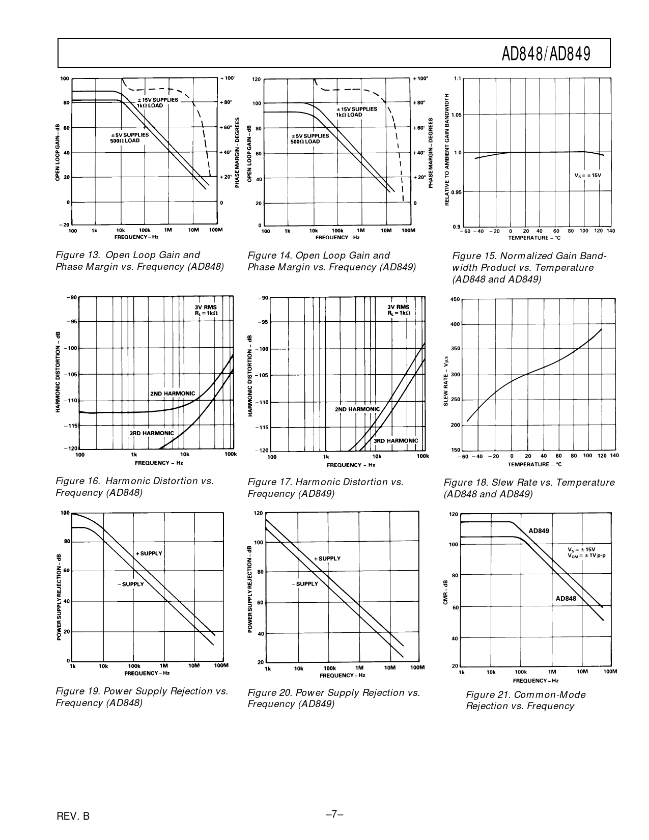

Figure 13. Open Loop Gain and Figure 14. Open Loop Gain and Figure 15. Normalized Gain Band- Phase Margin vs. Frequency (AD848) Phase Margin vs. Frequency (AD849) width Product vs. Temperature (AD848 and AD849) Figure 16. Harmonic Distortion vs. Figure 17. Harmonic Distortion vs. Figure 18. Slew Rate vs. Temperature Frequency (AD848) Frequency (AD849) (AD848 and AD849) Figure 19. Power Supply Rejection vs. Figure 20. Power Supply Rejection vs. Figure 21. Common-Mode Frequency (AD848) Frequency (AD849) Rejection vs. Frequency REV. B –7–
