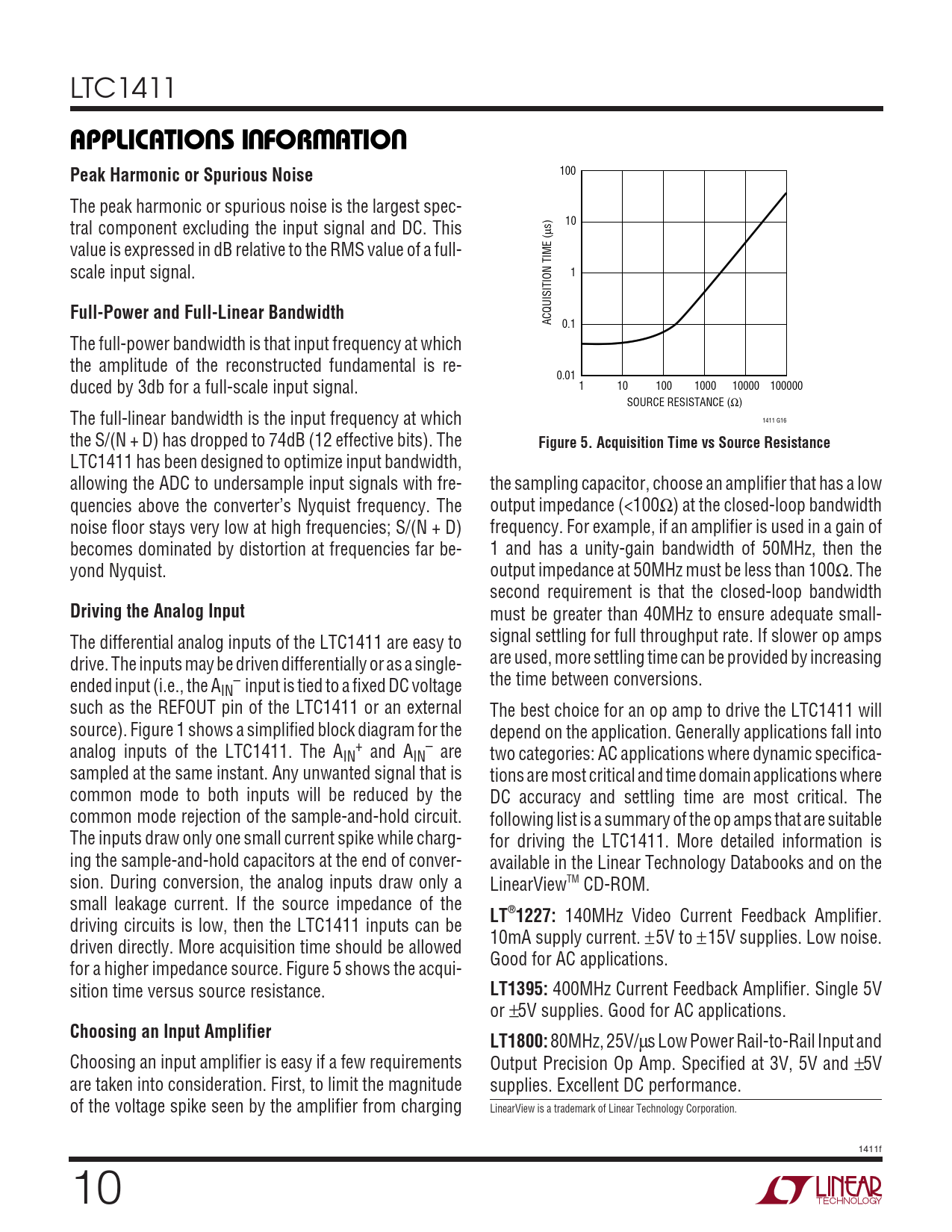

U U W U APPLICATIO S I FOR ATIO Peak Harmonic or Spurious Noise
100 The peak harmonic or spurious noise is the largest spec- tral component excluding the input signal and DC. This 10 µs) value is expressed in dB relative to the RMS value of a full- scale input signal. 1
Full-Power and Full-Linear Bandwidth
ACQUISITION TIME ( 0.1 The full-power bandwidth is that input frequency at which the amplitude of the reconstructed fundamental is re- 0.01 duced by 3db for a full-scale input signal. 1 10 100 1000 10000 100000 SOURCE RESISTANCE (Ω) The full-linear bandwidth is the input frequency at which 1411 G16 the S/(N + D) has dropped to 74dB (12 effective bits). The
Figure 5. Acquisition Time vs Source Resistance
LTC1411 has been designed to optimize input bandwidth, allowing the ADC to undersample input signals with fre- the sampling capacitor, choose an amplifier that has a low quencies above the converter’s Nyquist frequency. The output impedance (<100Ω) at the closed-loop bandwidth noise floor stays very low at high frequencies; S/(N + D) frequency. For example, if an amplifier is used in a gain of becomes dominated by distortion at frequencies far be- 1 and has a unity-gain bandwidth of 50MHz, then the yond Nyquist. output impedance at 50MHz must be less than 100Ω. The second requirement is that the closed-loop bandwidth
