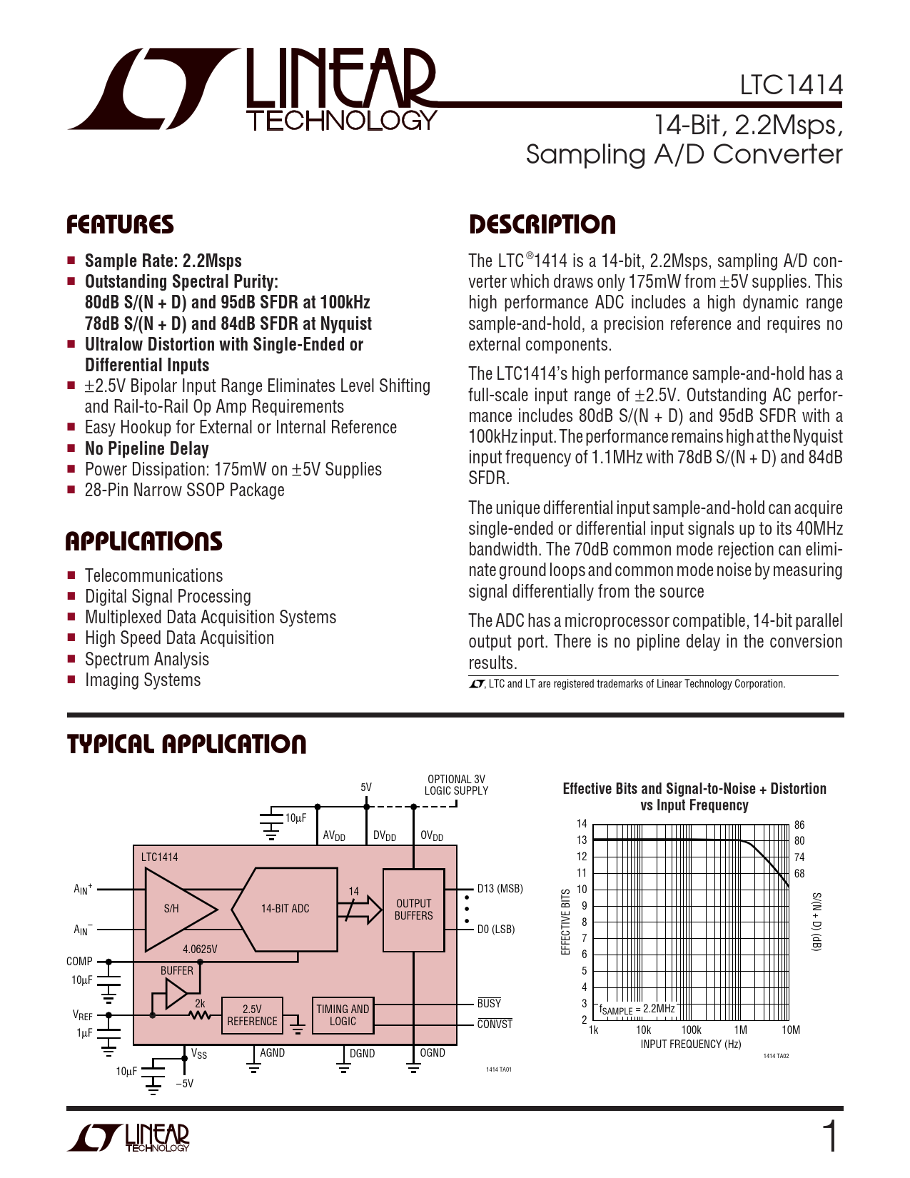

FEATURES. DESCRIPTIO. Sample Rate: 2.2Msps. Outstanding Spectral Purity:. 80dB S/(N + D) and 95dB SFDR at 100kHz
Datasheet LTC1414 Analog Devices
LTC1414 14-Bit, 2.2Msps, Sampling A/D Converter
U FEATURES DESCRIPTIO
The LTC ®1414 is a 14-bit, 2.2Msps, sampling A/D con- ■
verter which draws only 175mW from ±5V supplies. This
high performance ADC includes a high dynamic range
78dB S/(N + D) and 84dB SFDR at Nyquist
sample-and-hold, a precision reference and requires no ■
Ultralow Distortion with Single-Ended or
external components.
Differential Inputs
The LTC1414’s high performance sample-and-hold has a ■ ±2.5V Bipolar Input Range Eliminates Level Shifting full-scale input range of ±2.5V. Outstanding AC perfor- and Rail-to-Rail Op Amp Requirements mance includes 80dB S/(N + D) and 95dB SFDR with a ■ Easy Hookup for External or Internal Reference 100kHz input. The performance remains high at the Nyquist ■
No Pipeline Delay
input frequency of 1.1MHz with 78dB S/(N + D) and 84dB ■ Power Dissipation: 175mW on ±5V Supplies SFDR. ■ 28-Pin Narrow SSOP Package The unique differential input sample-and-hold can acquire
