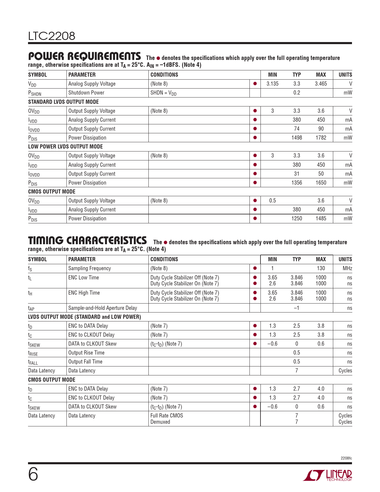

The. POWER REQUIREMENTS. denotes the specifi cations which apply over the full operating temperature
The POWER REQUIREMENTS denotes the specifi cations which apply over the full operating temperature
LTC2208
l
denotes the specifi cations which apply over the full operating temperature range, otherwise specifi cations are at TA = 25°C. AIN = –1dBFS. (Note 4) SYMBOL PARAMETER CONDITIONS MIN TYP MAX UNITS
VDD Analog Supply Voltage (Note 8) l 3.135 3.3 3.465 V PSHDN Shutdown Power SHDN = VDD 0.2 mW
STANDARD LVDS OUTPUT MODE
OVDD Output Supply Voltage (Note 8) l 3 3.3 3.6 V IVDD Analog Supply Current l 380 450 mA IOVDD Output Supply Current l 74 90 mA PDIS Power Dissipation l 1498 1782 mW
LOW POWER LVDS OUTPUT MODE
OVDD Output Supply Voltage (Note 8) l 3 3.3 3.6 V IVDD Analog Supply Current l 380 450 mA IOVDD Output Supply Current l 31 50 mA PDIS Power Dissipation l 1356 1650 mW
CMOS OUTPUT MODE
OVDD Output Supply Voltage (Note 8) l 0.5 3.6 V IVDD Analog Supply Current l 380 450 mA PDIS Power Dissipation l 1250 1485 mW
The TIMING CHARACTERISTICS
l
denotes the specifi cations which apply over the full operating temperature range, otherwise specifi cations are at TA = 25°C. (Note 4) SYMBOL PARAMETER CONDITIONS MIN TYP MAX UNITS
fS Sampling Frequency (Note 8) l 1 130 MHz tL ENC Low Time Duty Cycle Stabilizer Off (Note 7) l 3.65 3.846 1000 ns Duty Cycle Stabilizer On (Note 7) l 2.6 3.846 1000 ns tH ENC High Time Duty Cycle Stabilizer Off (Note 7) l 3.65 3.846 1000 ns Duty Cycle Stabilizer On (Note 7) l 2.6 3.846 1000 ns tAP Sample-and-Hold Aperture Delay –1 ns
LVDS OUTPUT MODE (STANDARD and LOW POWER)
tD ENC to DATA Delay (Note 7) l 1.3 2.5 3.8 ns tC ENC to CLKOUT Delay (Note 7) l 1.3 2.5 3.8 ns tSKEW DATA to CLKOUT Skew (tC-tD) (Note 7) l –0.6 0 0.6 ns tRISE Output Rise Time 0.5 ns tFALL Output Fall Time 0.5 ns Data Latency Data Latency 7 Cycles
CMOS OUTPUT MODE
tD ENC to DATA Delay (Note 7) l 1.3 2.7 4.0 ns tC ENC to CLKOUT Delay (Note 7) l 1.3 2.7 4.0 ns tSKEW DATA to CLKOUT Skew (tC-tD) (Note 7) l –0.6 0 0.6 ns Data Latency Data Latency Full Rate CMOS 7 Cycles Demuxed 7 Cycles 2208fc 6
