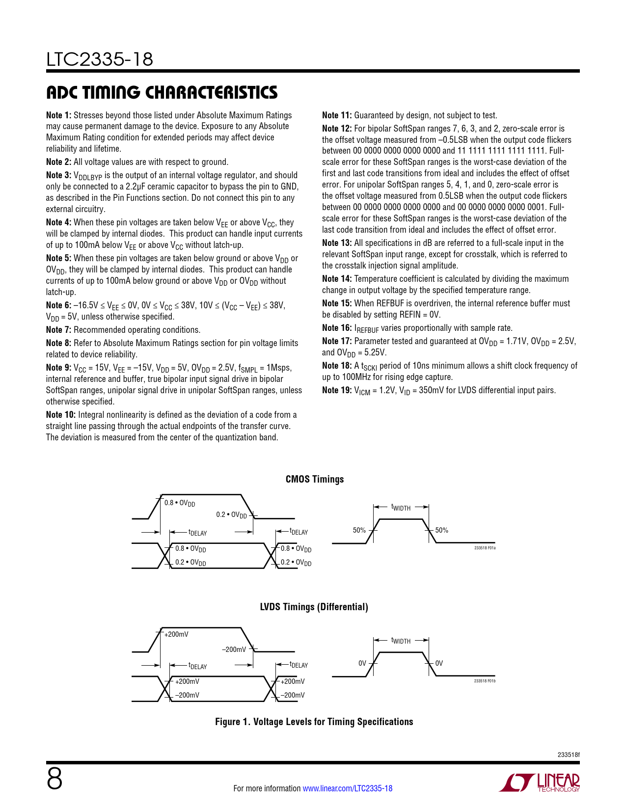

CMOS Timings
0.8 • OVDD tWIDTH 0.2 • OVDD t tDELAY 50% 50% DELAY 233518 F01a 0.8 • OVDD 0.8 • OVDD 0.2 • OVDD 0.2 • OVDD
LVDS Timings (Differential)
+200mV tWIDTH –200mV t tDELAY 0V 0V DELAY 233518 F01b +200mV +200mV –200mV –200mV
Figure 1. Voltage Levels for Timing Specifications
