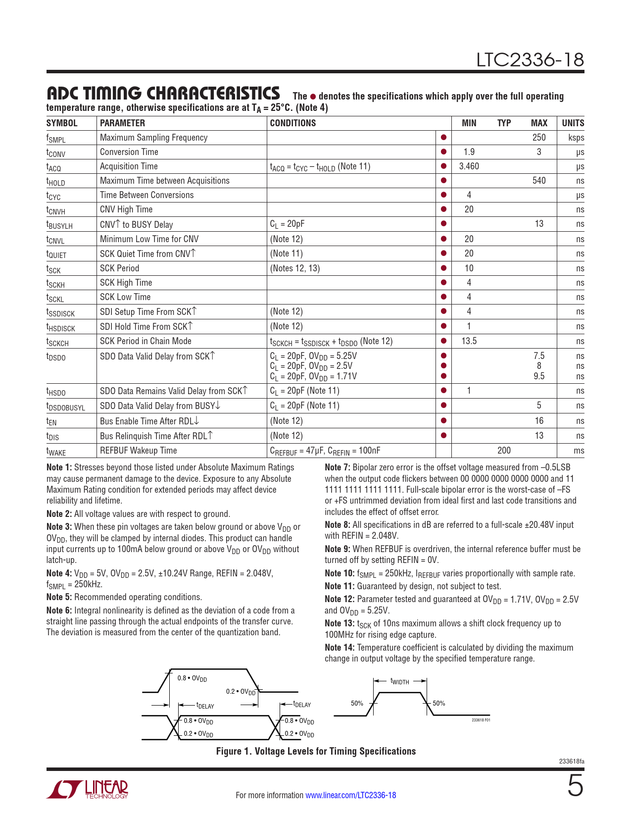

ADC TIMING CHARACTERISTICS. The. denotes the specifications which apply over the full operating
ADC TIMING CHARACTERISTICS The denotes the specifications which apply over the full operating
LTC2336-18
l
denotes the specifications which apply over the full operating temperature range, otherwise specifications are at TA = 25°C. (Note 4) SYMBOL PARAMETER CONDITIONS MIN TYP MAX UNITS
fSMPL Maximum Sampling Frequency l 250 ksps tCONV Conversion Time l 1.9 3 µs tACQ Acquisition Time tACQ = tCYC – tHOLD (Note 11) l 3.460 µs tHOLD Maximum Time between Acquisitions l 540 ns tCYC Time Between Conversions l 4 µs tCNVH CNV High Time l 20 ns tBUSYLH CNV↑ to BUSY Delay CL = 20pF l 13 ns tCNVL Minimum Low Time for CNV (Note 12) l 20 ns tQUIET SCK Quiet Time from CNV↑ (Note 11) l 20 ns tSCK SCK Period (Notes 12, 13) l 10 ns tSCKH SCK High Time l 4 ns tSCKL SCK Low Time l 4 ns tSSDISCK SDI Setup Time From SCK↑ (Note 12) l 4 ns tHSDISCK SDI Hold Time From SCK↑ (Note 12) l 1 ns tSCKCH SCK Period in Chain Mode tSCKCH = tSSDISCK + tDSDO (Note 12) l 13.5 ns tDSDO SDO Data Valid Delay from SCK↑ CL = 20pF, OVDD = 5.25V l 7.5 ns CL = 20pF, OVDD = 2.5V l 8 ns CL = 20pF, OVDD = 1.71V l 9.5 ns tHSDO SDO Data Remains Valid Delay from SCK↑ CL = 20pF (Note 11) l 1 ns tDSDOBUSYL SDO Data Valid Delay from BUSY↓ CL = 20pF (Note 11) l 5 ns tEN Bus Enable Time After RDL↓ (Note 12) l 16 ns tDIS Bus Relinquish Time After RDL↑ (Note 12) l 13 ns tWAKE REFBUF Wakeup Time CREFBUF = 47μF, CREFIN = 100nF 200 ms
Note 1:
Note 7:
Bipolar zero error is the offset voltage measured from –0.5LSB may cause permanent damage to the device. Exposure to any Absolute when the output code flickers between 00 0000 0000 0000 0000 and 11 Maximum Rating condition for extended periods may affect device 1111 1111 1111 1111. Full-scale bipolar error is the worst-case of –FS reliability and lifetime. or +FS untrimmed deviation from ideal first and last code transitions and
Note 2:
All voltage values are with respect to ground. includes the effect of offset error.
Note 3:
When these pin voltages are taken below ground or above V
Note 8:
All specifications in dB are referred to a full-scale ±20.48V input DD or OV with REFIN = 2.048V. DD, they will be clamped by internal diodes. This product can handle input currents up to 100mA below ground or above VDD or OVDD without
Note 9:
When REFBUF is overdriven, the internal reference buffer must be latch-up. turned off by setting REFIN = 0V.
Note 4:
VDD = 5V, OVDD = 2.5V, ±10.24V Range, REFIN = 2.048V,
Note 10:
fSMPL = 250kHz, IREFBUF varies proportionally with sample rate. fSMPL = 250kHz.
Note 11:
Guaranteed by design, not subject to test.
Note 5:
Recommended operating conditions.
Note 12:
Parameter tested and guaranteed at OVDD = 1.71V, OVDD = 2.5V
Note 6:
Integral nonlinearity is defined as the deviation of a code from a and OVDD = 5.25V. straight line passing through the actual endpoints of the transfer curve.
Note 13:
tSCK of 10ns maximum allows a shift clock frequency up to The deviation is measured from the center of the quantization band. 100MHz for rising edge capture.
Note 14:
Temperature coefficient is calculated by dividing the maximum change in output voltage by the specified temperature range. 0.8 • OVDD tWIDTH 0.2 • OVDD t tDELAY 50% 50% DELAY 233618 F01 0.8 • OVDD 0.8 • OVDD 0.2 • OVDD 0.2 • OVDD
Figure 1. Voltage Levels for Timing Specifications
