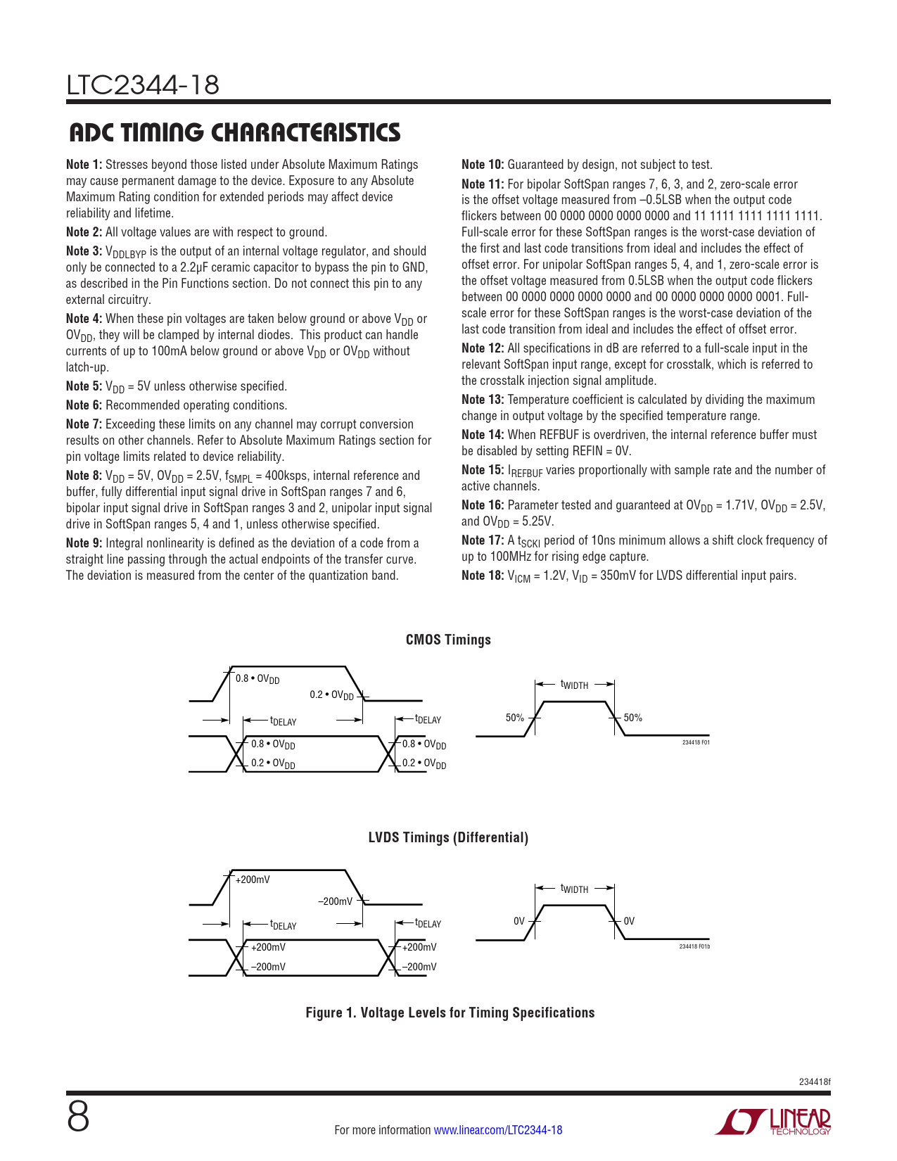

ADC TIMING CHARACTERISTICS. Note 1:. Note 10:. Note 11:. Note 2:. Note 3:. Note 4:. Note 12:. Note 5:. Note 6:. Note 13:. Note 7:. Note 14:
ADC TIMING CHARACTERISTICS Note 1: Note 10: Note 11: Note 2: Note 3: Note 4: Note 12: Note 5: Note 6: Note 13: Note 7: Note 14:
LTC2344-18
Note 10:
Guaranteed by design, not subject to test. may cause permanent damage to the device. Exposure to any Absolute
Note 11:
For bipolar SoftSpan ranges 7, 6, 3, and 2, zero-scale error Maximum Rating condition for extended periods may affect device is the offset voltage measured from –0.5LSB when the output code reliability and lifetime. flickers between 00 0000 0000 0000 0000 and 11 1111 1111 1111 1111.
Note 2:
All voltage values are with respect to ground. Full-scale error for these SoftSpan ranges is the worst-case deviation of
Note 3:
V the first and last code transitions from ideal and includes the effect of DDLBYP is the output of an internal voltage regulator, and should only be connected to a 2.2μF ceramic capacitor to bypass the pin to GND, offset error. For unipolar SoftSpan ranges 5, 4, and 1, zero-scale error is as described in the Pin Functions section. Do not connect this pin to any the offset voltage measured from 0.5LSB when the output code flickers external circuitry. between 00 0000 0000 0000 0000 and 00 0000 0000 0000 0001. Full-
Note 4:
When these pin voltages are taken below ground or above V scale error for these SoftSpan ranges is the worst-case deviation of the DD or OV last code transition from ideal and includes the effect of offset error. DD, they will be clamped by internal diodes. This product can handle currents of up to 100mA below ground or above V
Note 12:
All specifications in dB are referred to a full-scale input in the DD or OVDD without latch-up. relevant SoftSpan input range, except for crosstalk, which is referred to
Note 5:
V the crosstalk injection signal amplitude. DD = 5V unless otherwise specified.
Note 6:
Recommended operating conditions.
Note 13:
Temperature coefficient is calculated by dividing the maximum change in output voltage by the specified temperature range.
Note 7:
Exceeding these limits on any channel may corrupt conversion results on other channels. Refer to Absolute Maximum Ratings section for
Note 14:
When REFBUF is overdriven, the internal reference buffer must pin voltage limits related to device reliability. be disabled by setting REFIN = 0V.
Note 8:
V
Note 15:
I DD = 5V, OVDD = 2.5V, fSMPL = 400ksps, internal reference and REFBUF varies proportionally with sample rate and the number of buffer, fully differential input signal drive in SoftSpan ranges 7 and 6, active channels. bipolar input signal drive in SoftSpan ranges 3 and 2, unipolar input signal
Note 16:
Parameter tested and guaranteed at OVDD = 1.71V, OVDD = 2.5V, drive in SoftSpan ranges 5, 4 and 1, unless otherwise specified. and OVDD = 5.25V.
Note 9:
Integral nonlinearity is defined as the deviation of a code from a
Note 17:
A tSCKI period of 10ns minimum allows a shift clock frequency of straight line passing through the actual endpoints of the transfer curve. up to 100MHz for rising edge capture. The deviation is measured from the center of the quantization band.
Note 18:
VICM = 1.2V, VID = 350mV for LVDS differential input pairs.
CMOS Timings
0.8 • OVDD tWIDTH 0.2 • OVDD t tDELAY 50% 50% DELAY 234418 F01 0.8 • OVDD 0.8 • OVDD 0.2 • OVDD 0.2 • OVDD
LVDS Timings (Differential)
+200mV tWIDTH –200mV t tDELAY 0V 0V DELAY 234418 F01b +200mV +200mV –200mV –200mV
Figure 1. Voltage Levels for Timing Specifications
