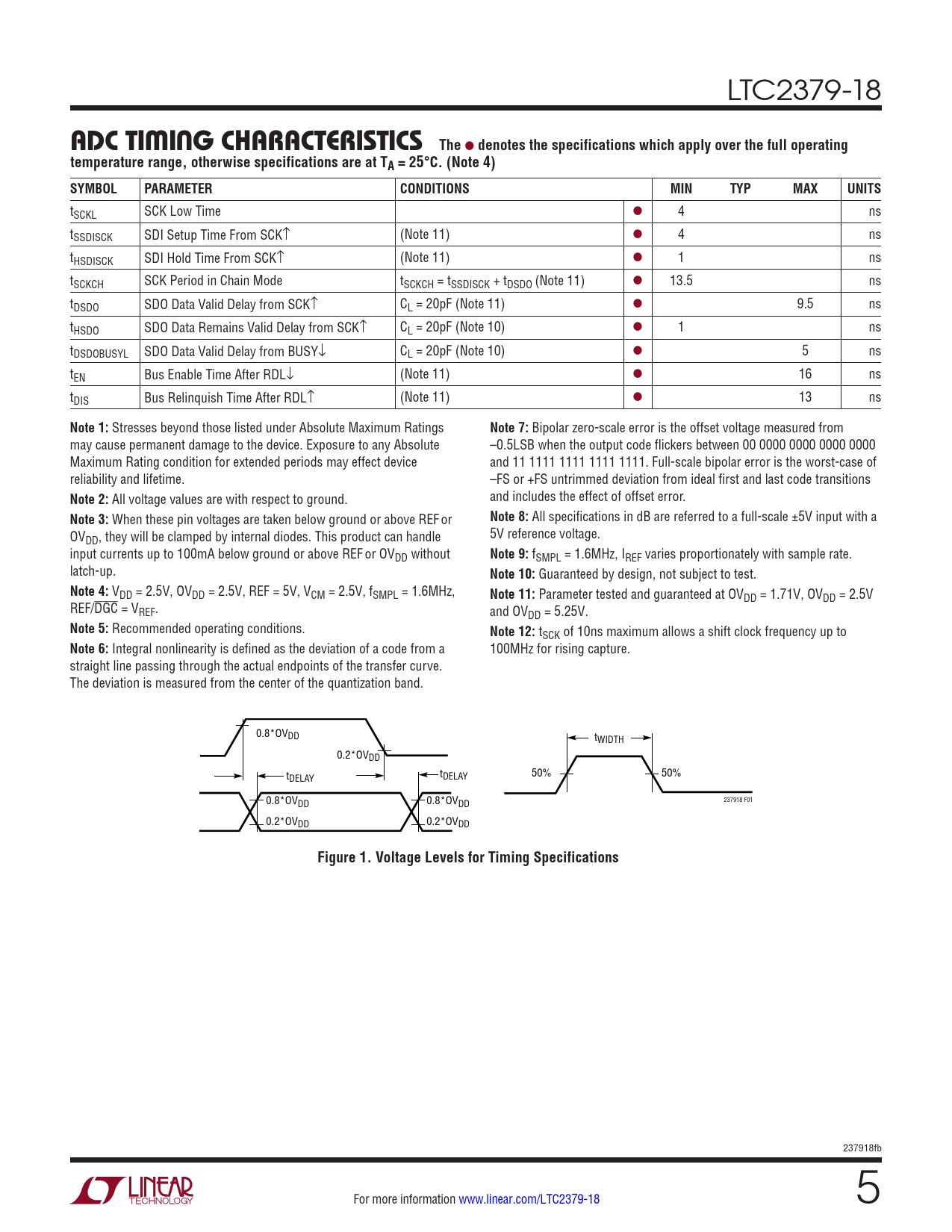

ADC TIMING CHARACTERISTICS. The. denotes the specifications which apply over the full operating
ADC TIMING CHARACTERISTICS The denotes the specifications which apply over the full operating
LTC2379-18
l
denotes the specifications which apply over the full operating temperature range, otherwise specifications are at TA = 25°C. (Note 4) SYMBOL PARAMETER CONDITIONS MIN TYP MAX UNITS
tSCKL SCK Low Time l 4 ns tSSDISCK SDI Setup Time From SCK↑ (Note 11) l 4 ns tHSDISCK SDI Hold Time From SCK↑ (Note 11) l 1 ns tSCKCH SCK Period in Chain Mode tSCKCH = tSSDISCK + tDSDO (Note 11) l 13.5 ns tDSDO SDO Data Valid Delay from SCK↑ CL = 20pF (Note 11) l 9.5 ns tHSDO SDO Data Remains Valid Delay from SCK↑ CL = 20pF (Note 10) l 1 ns tDSDOBUSYL SDO Data Valid Delay from BUSY↓ CL = 20pF (Note 10) l 5 ns tEN Bus Enable Time After RDL↓ (Note 11) l 16 ns tDIS Bus Relinquish Time After RDL↑ (Note 11) l 13 ns
Note 1:
Note 7:
Bipolar zero-scale error is the offset voltage measured from may cause permanent damage to the device. Exposure to any Absolute –0.5LSB when the output code flickers between 00 0000 0000 0000 0000 Maximum Rating condition for extended periods may effect device and 11 1111 1111 1111 1111. Full-scale bipolar error is the worst-case of reliability and lifetime. –FS or +FS untrimmed deviation from ideal first and last code transitions
Note 2:
All voltage values are with respect to ground. and includes the effect of offset error.
Note 3:
When these pin voltages are taken below ground or above REF or
Note 8:
All specifications in dB are referred to a full-scale ±5V input with a OV 5V reference voltage. DD, they will be clamped by internal diodes. This product can handle input currents up to 100mA below ground or above REF or OVDD without
Note 9:
fSMPL = 1.6MHz, IREF varies proportionately with sample rate. latch-up.
Note 10:
Guaranteed by design, not subject to test.
Note 4:
VDD = 2.5V, OVDD = 2.5V, REF = 5V, VCM = 2.5V, fSMPL = 1.6MHz,
Note 11:
Parameter tested and guaranteed at OVDD = 1.71V, OVDD = 2.5V REF/DGC = VREF. and OVDD = 5.25V.
Note 5:
Recommended operating conditions.
Note 12:
tSCK of 10ns maximum allows a shift clock frequency up to
Note 6:
Integral nonlinearity is defined as the deviation of a code from a 100MHz for rising capture. straight line passing through the actual endpoints of the transfer curve. The deviation is measured from the center of the quantization band. 0.8*OVDD tWIDTH 0.2*OVDD t tDELAY 50% 50% DELAY 237918 F01 0.8*OVDD 0.8*OVDD 0.2*OVDD 0.2*OVDD
Figure 1. Voltage Levels for Timing Specifications
