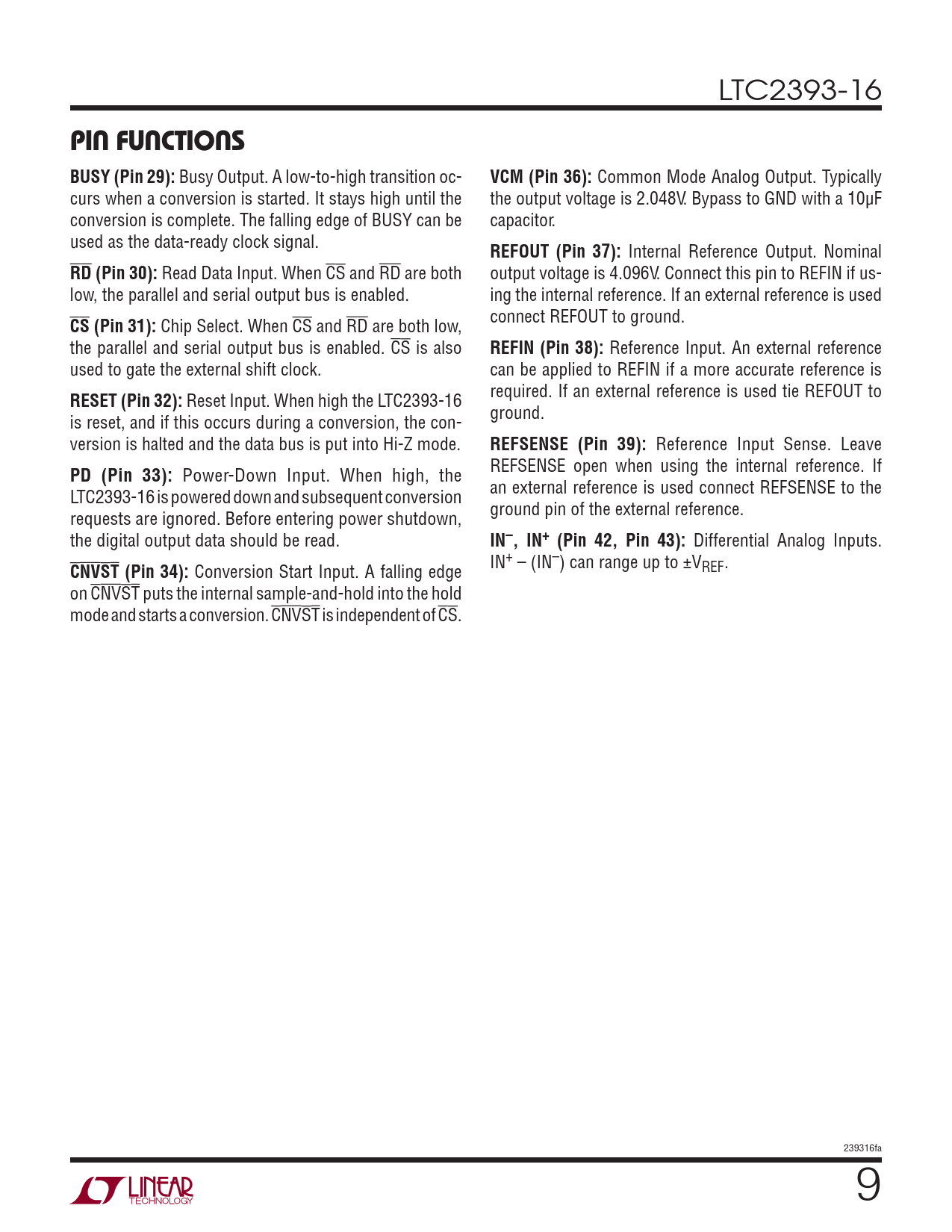

PIN FUNCTIONS. BUSY (Pin 29):. VCM (Pin 36):. REFOUT (Pin 37):. RD (Pin 30):. (Pin 31):. REFIN (Pin 38):. RESET (Pin 32):
PIN FUNCTIONS BUSY (Pin 29): VCM (Pin 36): REFOUT (Pin 37): RD (Pin 30): (Pin 31): REFIN (Pin 38): RESET (Pin 32):
LTC2393-16
Busy Output. A low-to-high transition oc-
VCM (Pin 36):
Common Mode Analog Output. Typically curs when a conversion is started. It stays high until the the output voltage is 2.048V. Bypass to GND with a 10μF conversion is complete. The falling edge of BUSY can be capacitor. used as the data-ready clock signal.
REFOUT (Pin 37):
Internal Reference Output. Nominal
RD (Pin 30):
Read Data Input. When CS and RD are both output voltage is 4.096V. Connect this pin to REFIN if us- low, the parallel and serial output bus is enabled. ing the internal reference. If an external reference is used
CS
connect REFOUT to ground.
(Pin 31):
Chip Select. When CS and RD are both low, the parallel and serial output bus is enabled. CS is also
REFIN (Pin 38):
Reference Input. An external reference used to gate the external shift clock. can be applied to REFIN if a more accurate reference is required. If an external reference is used tie REFOUT to
RESET (Pin 32):
Reset Input. When high the LTC2393-16 ground. is reset, and if this occurs during a conversion, the con- version is halted and the data bus is put into Hi-Z mode.
REFSENSE (Pin 39):
Reference Input Sense. Leave REFSENSE open when using the internal reference. If
PD (Pin 33):
Power-Down Input. When high, the an external reference is used connect REFSENSE to the LTC2393-16 is powered down and subsequent conversion ground pin of the external reference. requests are ignored. Before entering power shutdown, the digital output data should be read.
IN–, IN+ (Pin 42, Pin 43):
Differential Analog Inputs.
CNVST
IN+ – (IN–) can range up to ±V
(Pin 34):
Conversion Start Input. A falling edge REF . on CNVST puts the internal sample-and-hold into the hold mode and starts a conversion. CNVST is independent of CS. 239316fa 9
