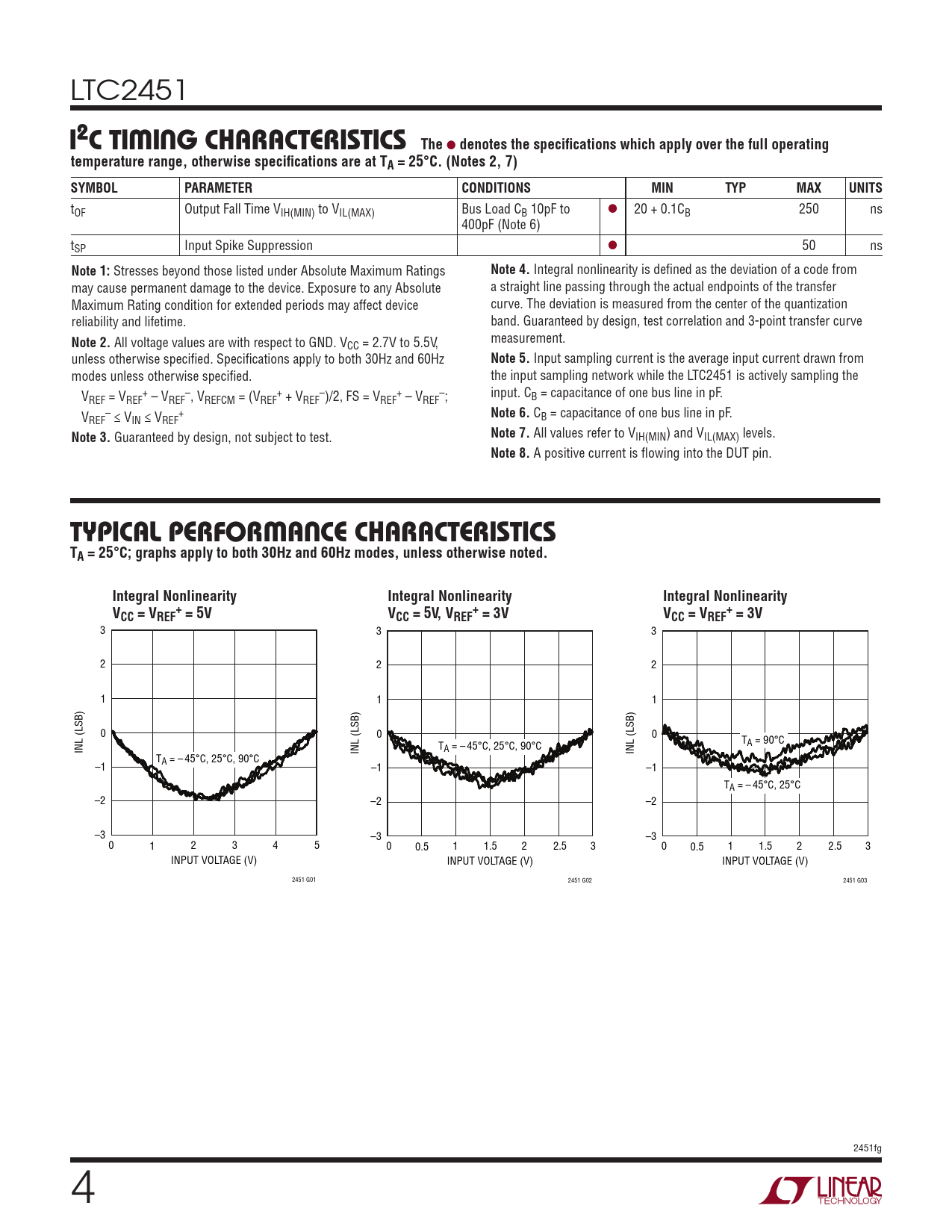

I2C TIMING CHARACTERISTICS The. denotes the specifications which apply over the full operating
I2C TIMING CHARACTERISTICS The denotes the specifications which apply over the full operating
LTC2451
l
denotes the specifications which apply over the full operating temperature range, otherwise specifications are at TA = 25°C. (Notes 2, 7) SYMBOL PARAMETER CONDITIONS MIN TYP MAX UNITS
tOF Output Fall Time VIH(MIN) to VIL(MAX) Bus Load CB 10pF to l 20 + 0.1CB 250 ns 400pF (Note 6) tSP Input Spike Suppression l 50 ns

TYPICAL PERFORMANCE CHARACTERISTICS TA = 25°C; graphs apply to both 30Hz and 60Hz modes, unless otherwise noted. Integral Nonlinearity Integral Nonlinearity Integral Nonlinearity V + + + CC = VREF = 5V VCC = 5V, VREF = 3V VCC = VREF = 3V
3 3 3 2 2 2 1 1 1 0 0 0 TA = 90°C INL (LSB) INL (LSB) TA = –45°C, 25°C, 90°C INL (LSB) T –1 A = – 45°C, 25°C, 90°C –1 –1 TA = –45°C, 25°C –2 –2 –2 –3 –3 –3 0 1 2 3 4 5 0 0.5 1 1.5 2 2.5 3 0 0.5 1 1.5 2 2.5 3 INPUT VOLTAGE (V) INPUT VOLTAGE (V) INPUT VOLTAGE (V) 2451 G01 2451 G02 2451 G03 2451fg 4 Document Outline Features Applications Description Typical Application Absolute Maximum Ratings Pin Configuration Order Information Electrical Characteristics Analog Input And References Power Requirements I2C Inputs And Outputs I2C Timing Characteristics Typical Performance Characteristics Pin Functions Block Diagram Applications Information Typical Applications Package Description Revision History Typical Application Related Parts
