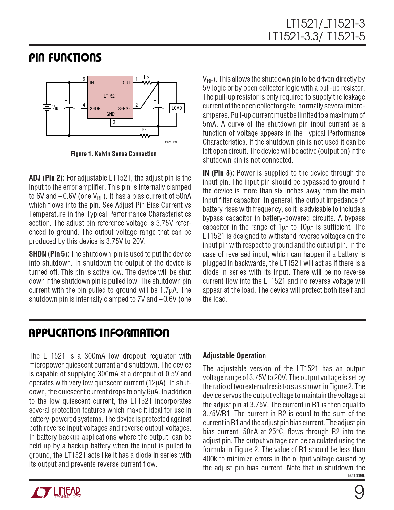

R 5 1 P VBE). This allows the shutdown pin to be driven directly by IN OUT 5V logic or by open collector logic with a pull-up resistor. LT1521 The pull-up resistor is only required to supply the leakage + + 4 2 V LOAD current of the open collector gate, normally several micro- IN SHDN SENSE GND amperes. Pull-up current must be limited to a maximum of 3 5mA. A curve of the shutdown pin input current as a RP function of voltage appears in the Typical Performance LT1521 • F01 Characteristics. If the shutdown pin is not used it can be left open circuit. The device will be active (output on) if the
Figure 1. Kelvin Sense Connection
shutdown pin is not connected.
